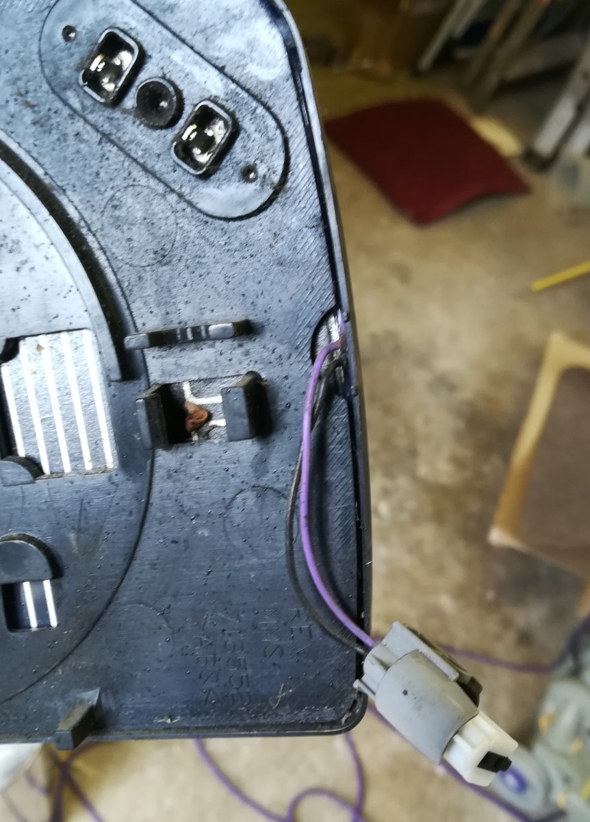

Post by Themoog2 » Mon Sep 16, 2019 3:03 pm
I'm swapping my door mirror as it got broken but the new one doesn't have the large plug on it. What does that do?

Re: Door mirror
Post by Gordon » Mon Sep 16, 2019 4:38 pm
If you look underneath the mirror housing there should be a downlight. The plug is for that

Re: Door mirror
Post by Themoog2 » Mon Sep 16, 2019 10:49 pm
Nope. The plug for the light is still in the housing.

Re: Door mirror
Post by Themoog2 » Mon Sep 16, 2019 10:56 pm
I think it may be for auto dimming. If anyone can confirm..

Re: Door mirror
Post by sleepyfolk » Mon Sep 16, 2019 11:11 pm
I did mine recently so I should know but my memory must be fading! I think there was a big plug which is for the auto dimming, and another small plug or connection for the heating to stop it misting up, got mine from Latvia on eBay for £60, better than the £300 from the dealer :o
