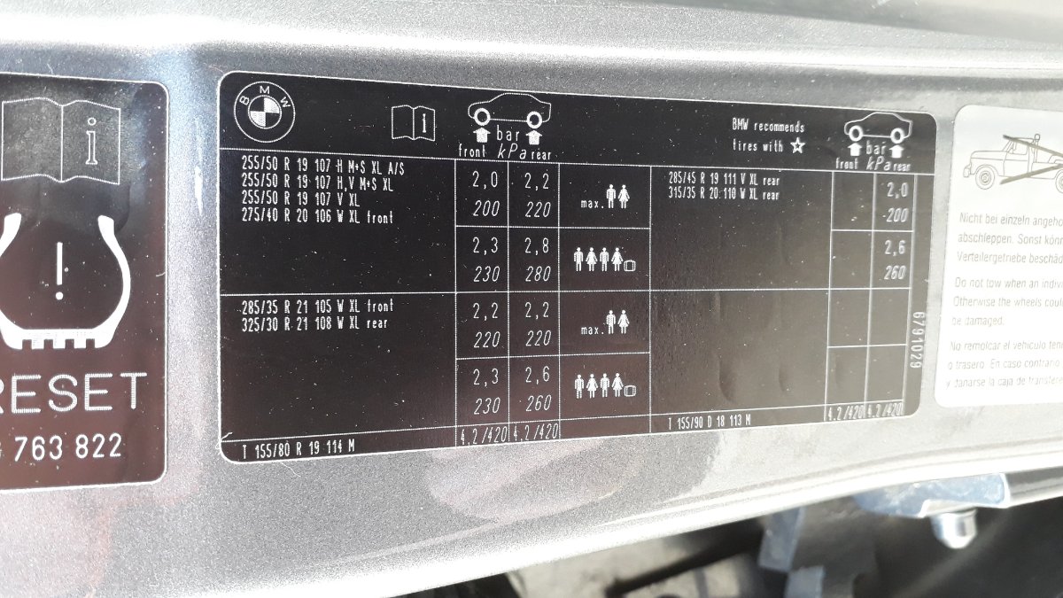

My drivers door plaque, as i read it, shows 2bar all round for an unladen vehicle, is this common place and the norm?
I also need to establish from any F86 owners what pressures are given for the winter option 285 40 20 tyres. Online info suggests that F models generally run higher pressures than the E series?
Actual, real information would be welcomed please :)

Mine says 2.2bar and yes that’s what I run it at (on 20” wheels)
Re: Tyre pressures, E71.
Post by marti » Wed Oct 23, 2019 5:33 pm
Me too...2.2bar

Post by sapphireblack » Wed Oct 23, 2019 5:54 pm
Perhaps i interpret it incorrectly ?

275.40.20 all round ? as there is no 285.40.20 listed and its 2.0 front 2.2 rear looking at your pic if I'm reading it right but there was usually a 315 rear in which case its 2.0 rear as well :D The narrower the tyre the more pressure by the look of it and with the 255's used front and rear the rear is at a higher pressure going by that !

I clearly read the door sticker as 2bar all four corners, 275/315 tyres, so that's what I do.

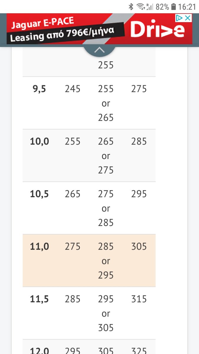

A 285 40 20 tyre wasn't an option on the E series vehicles but is on the F86 specifically. Winter sets spec'd for that are 285 40 20 all round on 10" front and 10.5" rear rims. I'm adopting that position, albeit on 10 & 11" E71 rims. 285s are happily compatible on these width rims, what I need are the suggested pressures 8)
