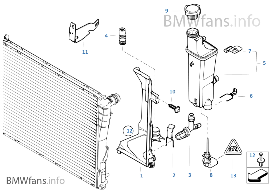

Post by henrym3 » Wed Oct 23, 2019 6:46 pm
Item 4 is listed as a thermostat
