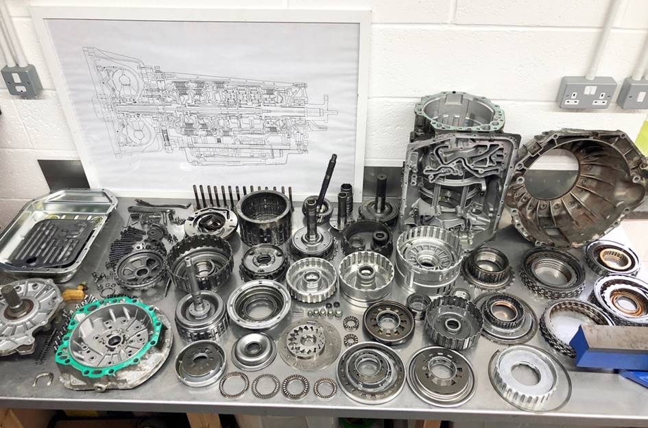

There could be two causes. One sounds awfully like mine a few years ago, and that was the gearbox itself failing after an issue with the torque converter - a part failed and jammed the box oil pump. The loss of pressure wrecked the clutch packs. The car would drive a little in forward but not reverse. It also made horrible metallic noises. The warning lights didn’t come on! As to why it suddenly went at 38k miles, who knows.
Unfortunately it had to have a complete gearbox rebuild. If it is a 2004 facelift version with the 6-speed then it will be the ZF GA26HPZ box.
My advice would be to not drive the car until you have had a gearbox error code read done. I had mine trailered to a BMW garage who diagnosed the box failure and offered to replace (not repair please note) the box for £7k! I declined.
My rebuild was done by A1 Premier Transmissions at Biggleswade. They are a ZF specialist and I used them a couple of years back to rebuild my E46 manual box too. They will recover the car from home (or in my case BMW in Milton Keynes). Driving it will very likely cause more serious damage. In 2008 it cost my warranty company £2,200 for a full rebuild, and I was without the car for a month. You can get exchange boxes for less but will need to remove and fit yourself. It shouldn’t affect the Mechatronics module, but if it does those are about £1,500 on top if a replacement is needed (mine did need it due to swarf ingestion), but that was plain bad luck and is not normally required.

As you have the 218bhp it’s the 6-sp ZF box in my original reply. As above, get a code read done first. The box is the expensive issue but it gets cheaper with the other possible faults and it is fixable :)
Mine went when pulling out too. If I remember correctly it was a plastic part in the Sprag Clutch in the TC that broke and somehow got into the oil pump. I could not see anything underneath and there were no leaks. The issues were identified when a code read was done at the Dealer and showed two clutch packs and two brake packs had failed meaning no more ‘drive’.
If it’s a box change then you don’t need any programming done because the Mechatronics module can just be swapped over if it’s OK. It is screwed to the bottom of the box. If it does need changing then A1 took the part only to a Bosch Autocentre in Hitchin (I think) who blew the relevant BMW programming into its ‘brain’ and that takes just a few minutes. That is only needed if it is a new Mech unit, or the replacement was sourced from another non-BMW car. That box was used in all sorts of vehicles.
The ZF major rebuild kit wasn’t expensive (£250 from memory) with a new oil pump, seals, fluids and a new TC coming to about £750. It was the 18 hours of labour that added up. It did come with a 12-month warranty and a service after 1,000 miles to make sure all was well.
