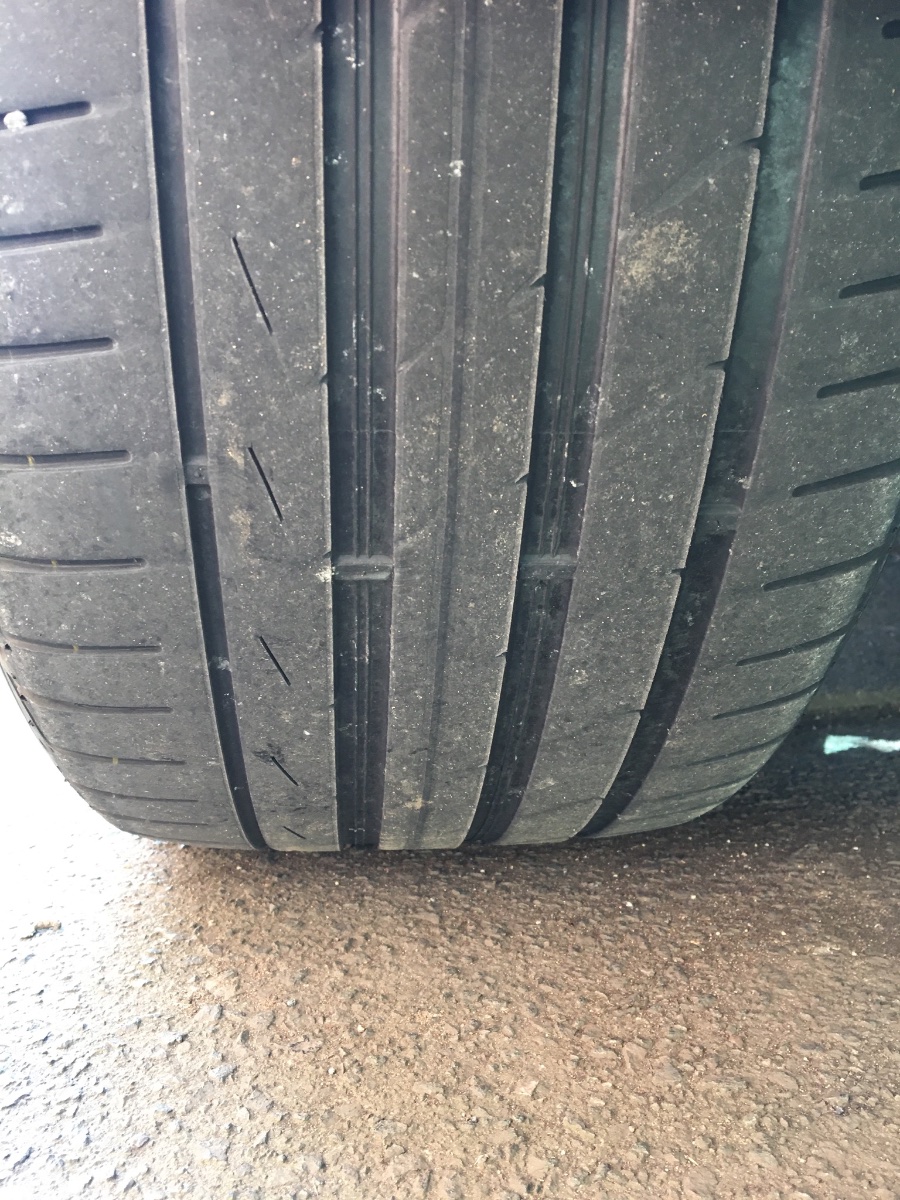

I currently have Hankook S1 EVO2 runflat fitted since Feb. I have done 3000 miles and am nearly down to the wear indicators ( emailed Hankook to tell them this and they couldn’t care less, told to send them back so they can investigate)

Re: Rear tyres for X3
Hi,
The rear alignment was done before the tyres went on, they have worn completely evenly. Just a little too quick.

It would seem these tyres have a super soft compound? Have you Googled to see if others have had the same experience as yourself.
Faulty tyres i would imagine is a rare event and certainly there would reports or knowledge of more than just your two.
If Hankook say return them, will your supplier help you with that? Would they have recorded the mileage on your purchase invoice?
