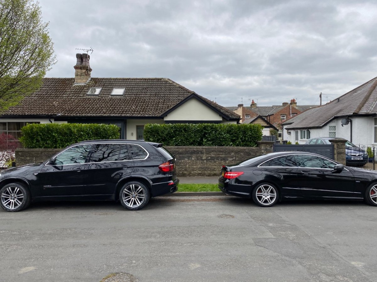

This is my car right now...

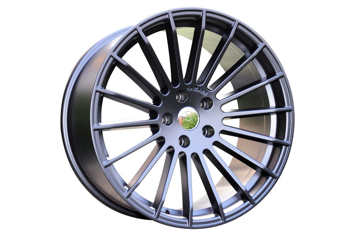

I'm wanting to put on some bigger shoes and have found some lovely 22’s from Haxer (HX010) but im conscious that tyres are expensive too! I can afford them (just) but dont want them looking too 'pimp my ride' or sticking out of the arches either. The tyres for these would have to be the Lexani LX-Thirty simply for affordability but ive also heard theyre good tyres for the X5 and larger alloys.
Im trying to get these same alloys above in a staggered 21 inch set up but if they're not available im happy to go non-staggered 21’s and then the tyres are the same all around...and much cheaper! The tyres for the 21’s are also easily affordable i.e blacklion BU66 etc so really makes sense whilst still adding to the visual drama and not really changing my driving pleasure by only going up 1’’ from 20’s.
I've read up on running non staggered and its seems that there is no advantage on the X5, apart from aesthetics at the rear. Its an AWD so doesnt benefit from a staggered set-up...please let me know otherwise!
My question is, if i go non staggered i.e 21x10 all around what tyre size should i be running and what offset? They look like ET40. Also what tyre pressure would you be running on this set up?

Like the standard alloys I have herd quite a lot of bad stories about after market wheels not having the correct weighting for the car so they end up cracking which is the last thing you want . Will they fit . com is a good source to get the correct offset aswell as alloy wheels direct . net as they have a good list of oem wheels and approved wheels , generally recommend star rated tyres run flat or none due to the nature of the diff problems . If you are planning on refurbishing the wheels why not go darker with your current ones and lower the car .

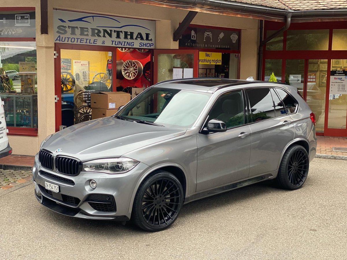

I have style 375 on my F15 21" 10j x 21 et40 front , 11.5j x 21 et38 rear but it still has a big gap between the tyre and arch ,so possibly try them on first to see it is what you are after !

285.35.21 tyres all round will be the size and cheap in the blacklion brand, a rated wet grip too. I have these on the front as I run a staggered set of genuine 21's. Pressure settings are on the b pillar for 21's. I suspect the rears in the pics have big spacers as they won't sit out that far normally.

I stuck with 20s, the ride is harsh enough on runflats as it is, worsening that by swapping to 21s isn't my idea of an improvement. 21 x 10 on the rear would mean spacers as well if the offsets are all the same, longer bolts and all a bit fussy. Not that you the driver will notice but 10 " rears will look wrong too.
Multi spoke wheels that you favour certainly look good but will be a real pita to keep clean, that alone would put me off. If you really want 21" I would personally seek out some original BMW rims. Style 128 looks pretty aggressive and style 215 also looks good, i was briefly tempted by a set of those myself.
