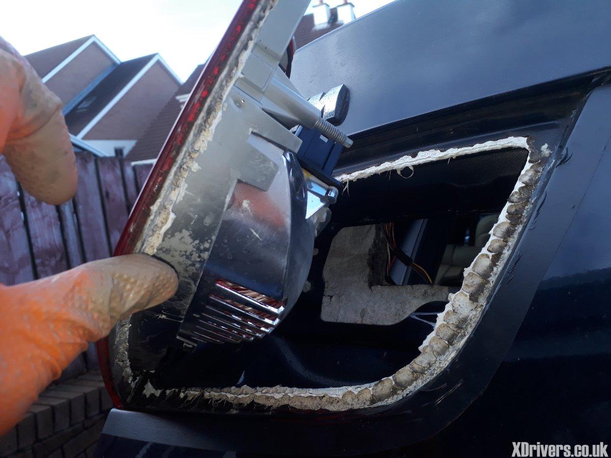

Door handle changed ,as you will know they go sticky and generally nasty with age , 14 quid ebay one good colour match but doesn't quite fit as well as genuine one ,one of the little clip slots broke on fitting as its too thin there . It mush be cast of a real one as all the little part number son the back are there too ! BMW had an indent rather than a slot for this reason i guess but at about 60 quid for a bit a plastic they can keep it lol. After that I decided Id fit a new genuine rear light seal as I was getting fog light out warnings earlier in the year when it was cold plus water was running out of the boot when it was lifted ,
I had replaced the other side when I got the car as the led had failed, I knew it was sealed on but it was a hell of a job to get it removed ,much heating and careful prying followed took abut 20 mins to remove and an age to get all the crap of the light with much scraping and using petrol so soften it and also remove the sealer on the boot ! Refitted now new seal which is foam , the clip is a right bugger to fit correctly through the little bulb replacement slot in the tailgate.
Light works fine but got a high rate of discharge for my trouble after having the boot open so long and clock reset so on the Ctek now as its been sitting a week anyway not moving.

I guess most cars get the same faults after a few years :D , I don't really like the way its held on with one stud which doesn't give even pressure to the gasket but we shall see how it goes , the sealer was doing a great job in the places it was put on but any tiny gaps have leaked ,i'm guessing this is where the water coming out of the bootlid drain is coming from anyway . I can't get it to sit perfect ,other side isn't sitting 100% either but its the best i can do !
Its had 2 bootlid lights before by the look of it , cheap ones but I put an oe one on drivers side after that and if I even have to change this one will get another oe one.
