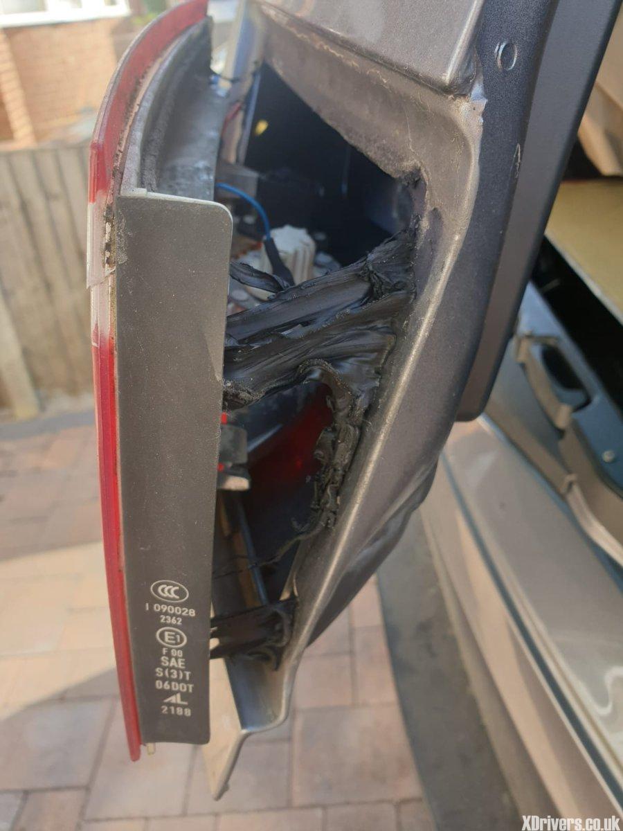

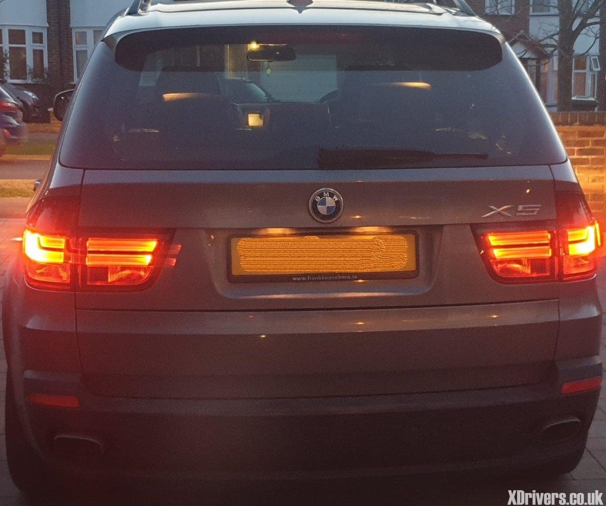

Post by rehan » Tue Apr 06, 2021 9:04 pm
Hi All,
Well the lights took longer than expected to arrive. It was a UK seller, but they actually came from Poland. While it was taking some time to get here, I asked the seller about them, and they assured me I wouldn't get hit with any import duty.
Here are the results, hope the pictures come through!

Overall the quality for what they are (aftermarket) was about 90% satisfactory, and I'm quite picky. Only reservation is the lamp mount on the back of the lights look a little flimsy. A resistor is provided in-line to the connector, as the units don't have a secondary brake light. The units come with rubber foam gaskets which are good. Fitting them are straightforward after a good cleanup of the old butyl sealant. Isopropyl alcohol worked good for this.
I did have the right indicator fail on me. Wiggled the cable and it's been fine since, so let's see how long it lasts before I need to check the connectors again.
All other lights work, including both foglights. I don't see it being an issue passing the MOT, as they are all bright enough, despite the kind of smoked look to it. Seem brighter than the originals, although mine were weathered!
