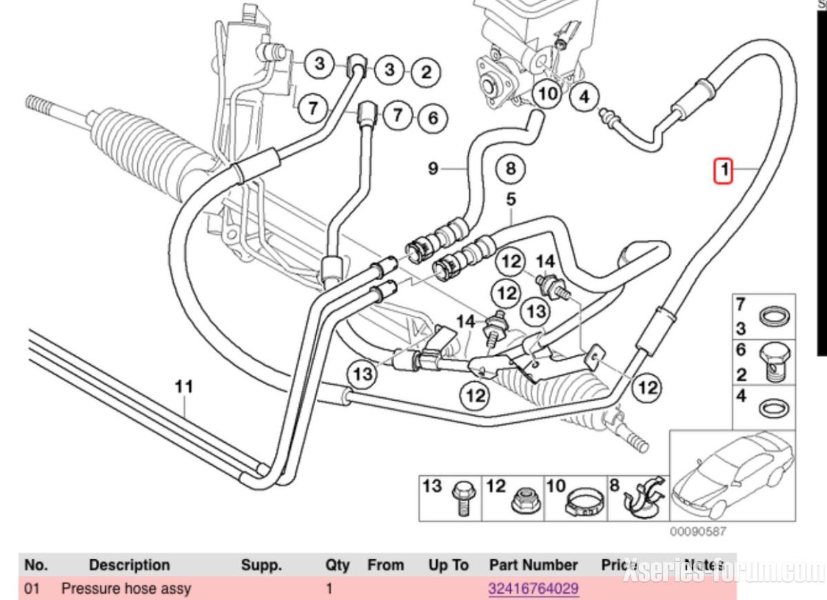

The jobs you've listed are not a specialist bmw job, any decent garage would be able to carry those jobs out, I use the local tyre and battery auto centre for simple tasks, they're quite good actually, and a lot cheaper than a specialist indie.
As for the pas pressure pipe, if you're going to to do it yourself don't buy second hand, you never know the condition of a used item, especially a hose.

All the jobs are well within the capacity of a reasonable home mechanic let alone a garage, the messy one is the power steering line as it will mean draining down the system. If DIYing Don't reuse old fluid.
Just check online realoem for the part number then google for a new price fitting as has been said is well within the scope of any competent mechanic.

The PAS pipe that needs changing is the one labelled 1 in the picture. Can it be replaced from the bottom of the car or the whole front bumper needs to come off to get access for connecting to part labelled (3) ?
