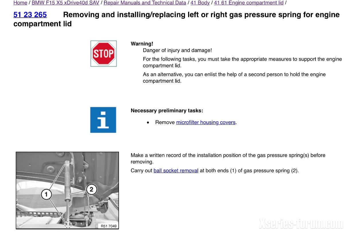

The ‘pedestrian guard’ system comprises a pyrotechnic gas generator on each bonnet hinge mount, and gas struts.
Part number: 51237308065. Febi versions are £71.00 each. These are specific for vehicles fitted with SA8TF
There is a specific service line item against the F15 & F16 to replace the gas struts before the expiry date.
=> F15/16 New testing point:
On vehicles with active pedestrian impact mitigation (SA8TF) check expiry date of gas struts. Expiry must not be before next brake fluid service. If necessary replace at extra charge. Change interval 5 years from date of manufacture.
Change procedure (the only one listed)
It does say to get the pressure off first as the spring is under pre-load!
It doesn’t mention the pyros. Those are about £180 each.
