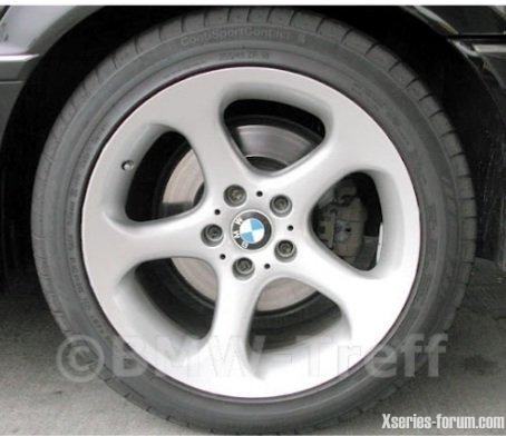

Type 69, 8.5 x 18 all round. I think 18" is the smallest diameter on a 4.6 🤔
Plenty of other options though. http://www.bmwstylewheels.com/
Screenshot_20220810-082125_Samsung Internet.jpg (27.53 KiB) Viewed 1370 times

Saphire Black is correct 255 x 55x 18 is the size I always ran Vred Wintrac Extreme on the 4.6 as anything smaller doesn't clear the Brake caliper
