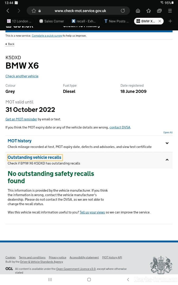

Post by sapphireblack » Sat Sep 03, 2022 11:48 am
Nothing on mine so far 🤔
Screenshot_20220903-134412_Samsung Internet.jpg (96.43 KiB) Viewed 2752 times
