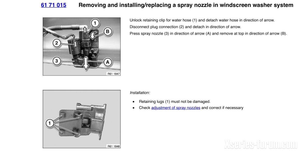

If you can detach them and then try a squirt, it may clear the line…image below..
Adjustment (if needed is as below…
