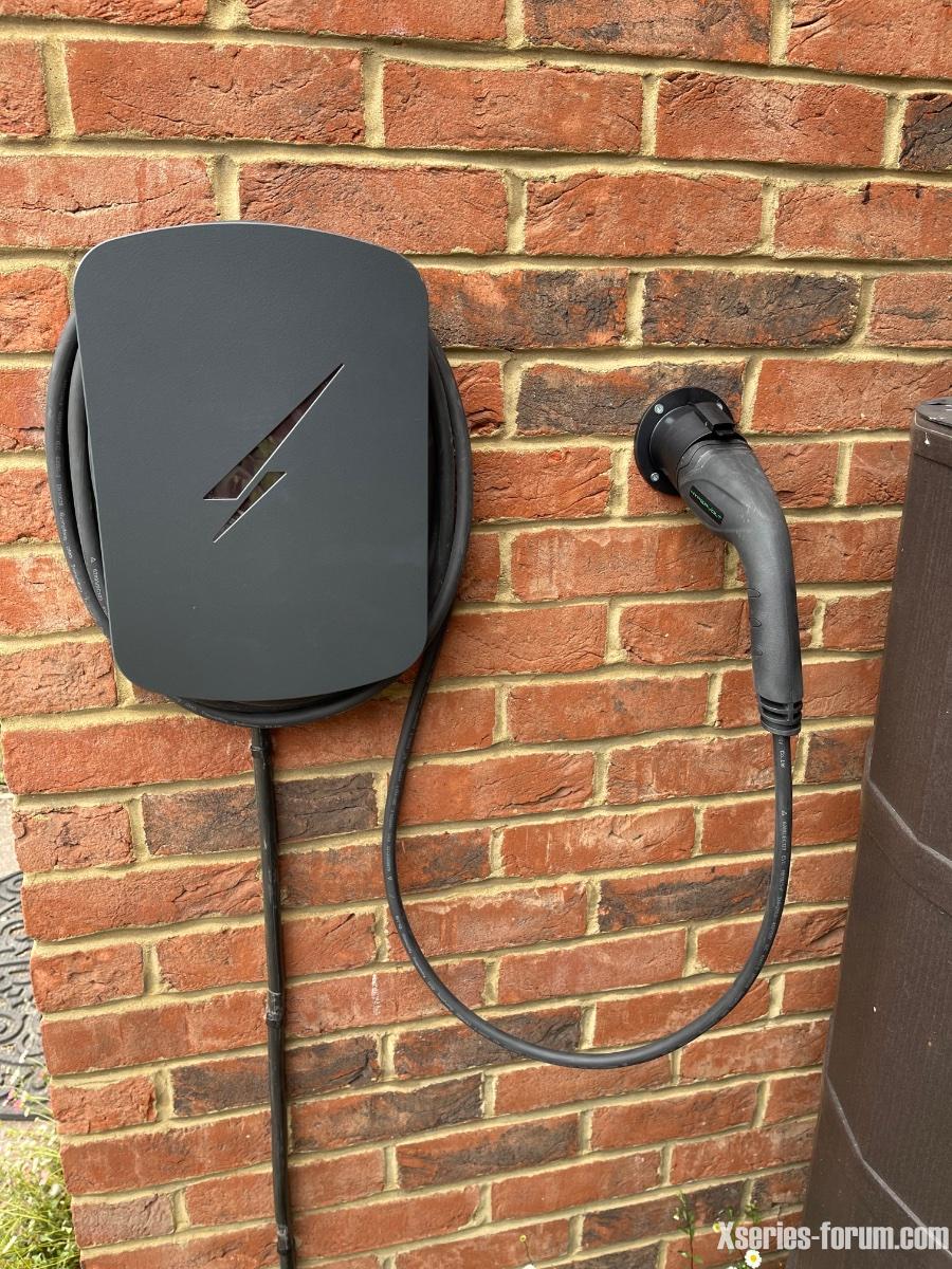

They may not have had it installed yet? There’s backlog of orders at present due to demand. I had to wait a couple of months to get our system installed.
You’re looking at something like this (Hypervolt 2 7kW/h smart charger (smart chargers are mandated now)). That has a 10m permanently attached trailing cable to the car so it can be anywhere in our drive - no room in the garage! - to charge the car. Tesla wall boxes are of a similar size.

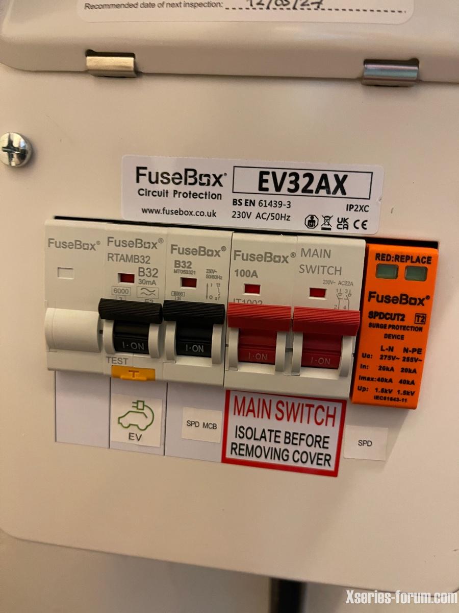

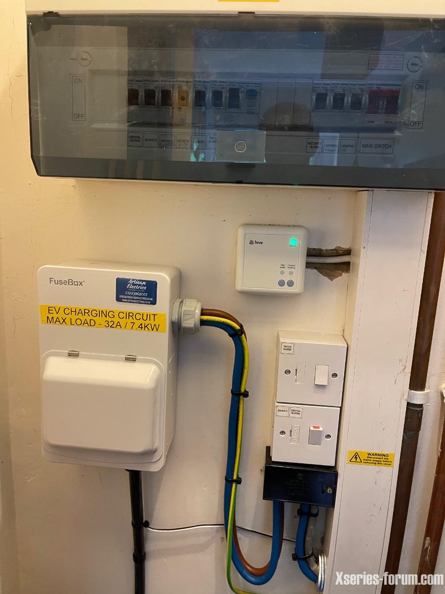

Electrical circuits (new 32A circuit separate from the house (additional tails from just below the main fuseboard)). The circuits were separately installed to ensure zero risk of a fault in the car charger sending 470V DC into the house mains. That would be ‘bad’ :D Anti surge/lightning protection also included (the orange thing).
In my case it’s a 12 metre run to the charger and that’s done with 6mm armoured EV cable which includes Cat 5 Ethernet for the ‘smart’ functions. The Hypervolt is connected via WiFi at present.

What we have is this:
Meter to fuse board tails are split with one pair going to house systems and the other to the EV breakers. From there a dedicated feed goes via 6mm armoured back through the wall to the front of the house where the charger is. The cable is clipped to an outside wall at low level and the run is out of sight until it gets to run under the front door to the charger. The electricians did a really good job. The external cable is just over 1/2” diameter.
If you can run inside then 32A (6mm/sq) twin & earth is fine, no armoured cable needed. That was what I wanted to do originally but finding a sensible route was impossible and the length nearer 30m meaning I needed much beefier wires (10mm/sq) to avoid volt drops. That made going around corners a mare due to minimum bend radius ‘challenges’.
The thin black/white wire is from a sensor that monitors the house ‘demand’ and if high then ramps the charge rate down accordingly. That sensor is on the smart meter on the other side of that wall.

Our charger installer told us the recommendation was to keep the EV circuit completely separate, add anti-surge and a Type B main circuit breaker. Most houses use Type A that cannot detect DC so won’t trip in the event of a ‘leak’ from the car.

Just as well I don't desire an EV then. That black cable exiting the bottom of the EV box is the one fed to the exterior connection point?.

That’s the beastie, yes. Our wiring centre is in the airing cupboard with the meters the other side of the same wall. It goes down far enough to miss the meter box then out through that wall.
