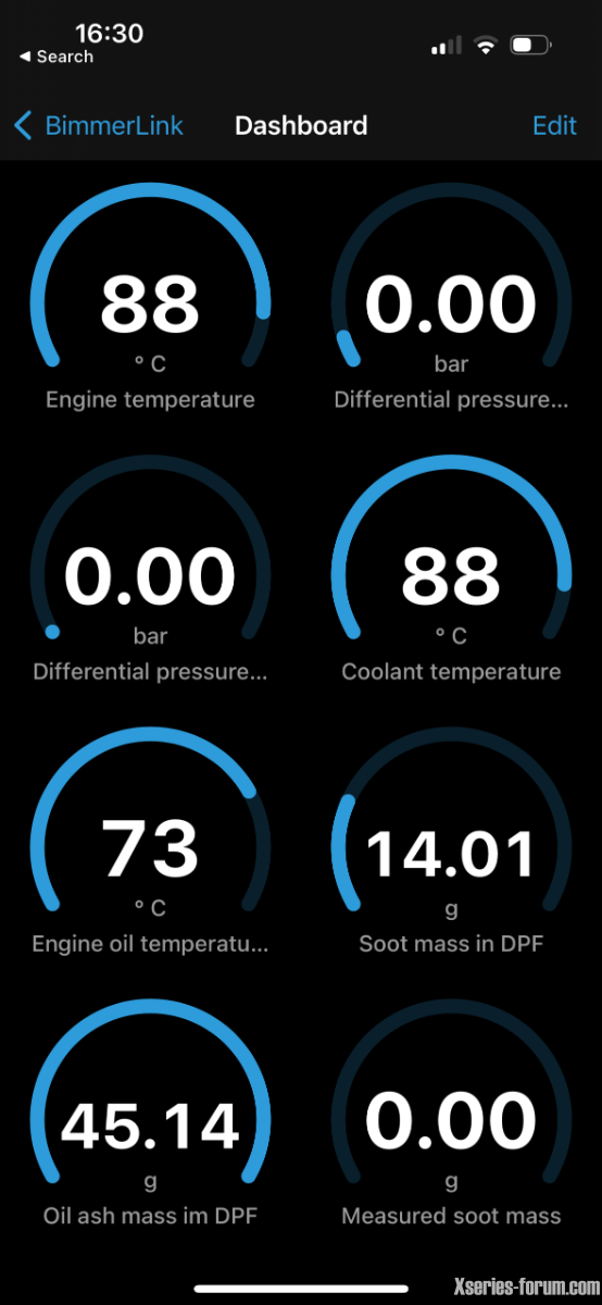

The code "48EC" does come back when cleared. Is this not referring to the pressure sensor inside the ECU? Not sure how that would show up as it seemed to be triggered when I changed Intake manifold pressure sensor. I did use a non-OEM part so maybe this is impacting in some way. Might try to clean the original one and and replace it to check.
I now also have the following codes showing up and and engine warning light that before flashed up and disappeared occasionally but now sticking:
4C9F: exhaust gas recirculation valve, plausibility
4C9E: exhaust gas recirculation valve, plausibility
The EGR was checked and found to be clean last year but I guess it may need replacing.
Can't seem to go on a trip without having the engine warning light come up at some point
