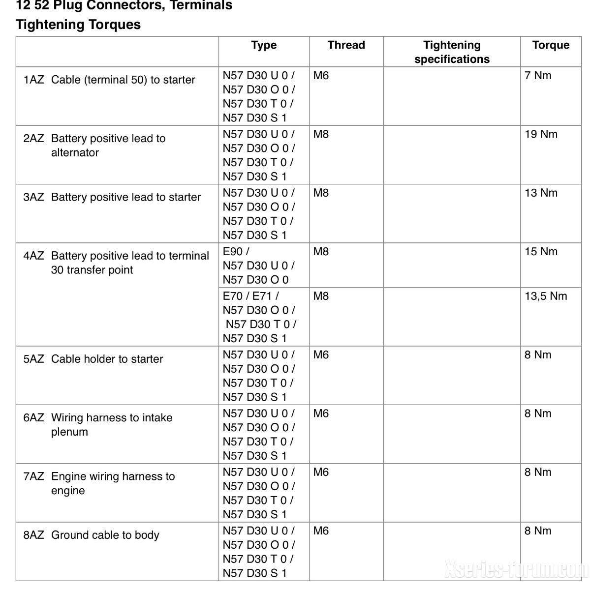

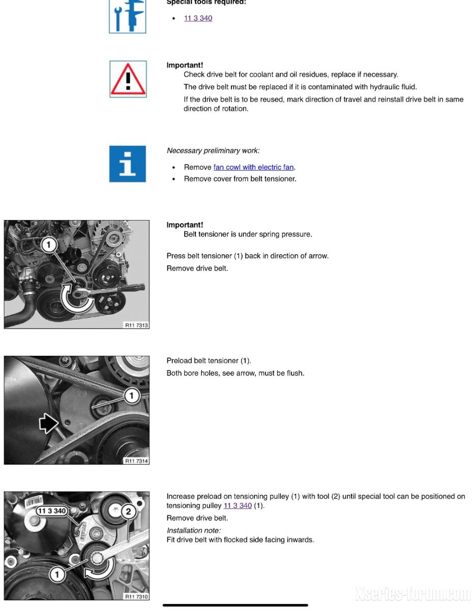

Change procedure - if you need it…..
12 31 Alternator with mounting
Tightening Torques
Type Thread Tightening specifications Torque
1AZ Alternator to holder
N57 D30 O 0 / N57 D30 T 0 / N57 D30 S 1 M10 38 Nm
2AZ Deflecting element to belt tensioner
N57 D30 S 1 M10 55 Nm

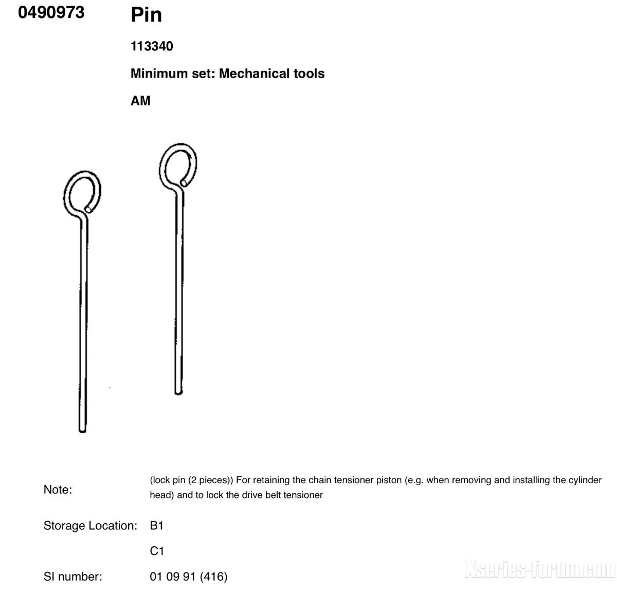

Special tool - basically a steel rod to lock the tensioner
Belt tensioner
