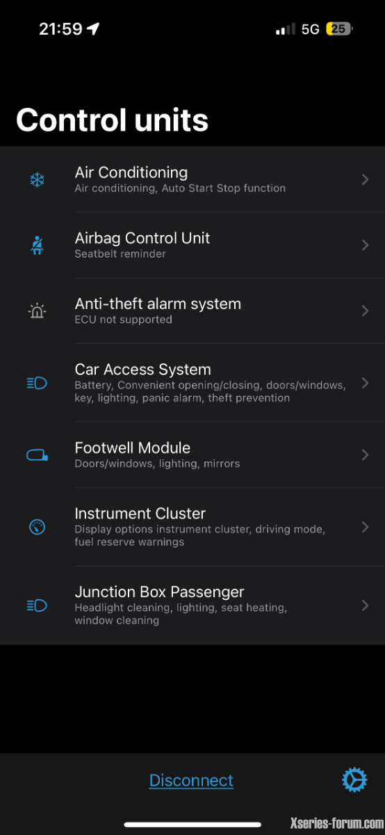

I’ve recently purchased a X1 20D M Sport. The vehicle came with a parking sensor fault and upon arrival and a quick inspection, another fault was displayed being the inspection now (vehicle on a ramp) coming up in yellow. Will attach an image.
I know there is a PDC module in the boot that typically gets wet, however I’ve not had that issue.
Also, I’ve noticed that after putting the vehicle in reverse, only the passenger side mirror will tilt downwards. However, when i press the button on the drivers door (once parked) both mirrors will fold up and close.

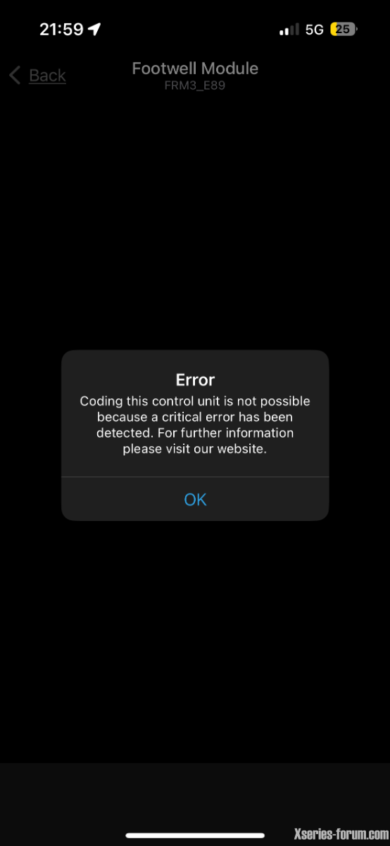

I also noticed when attempting to use BimmerCode to update some of the features I was greeted with an error message when trying to access the footwell control module. Will also attach an image.

As far as coding goes, not everything can be coded or adjusted. I use Carly and it offers all sorts of options, however depending upon the car’s market (EU/US/Japan etc) some are not actually available. The code change is accepted but ignored.
For the very latest models with iDrive 8.5 (and 9 imminently), BMW have introduced a code lock that requires a ‘token’ from the factory. You can’t get that unless the car is plugged in at a Dealer. Of course Dealers won’t code anything that you might want enabled as it puts them in the hook for it in the event if an accident or other incident. The days of tinkering are sadly on the wane now.
