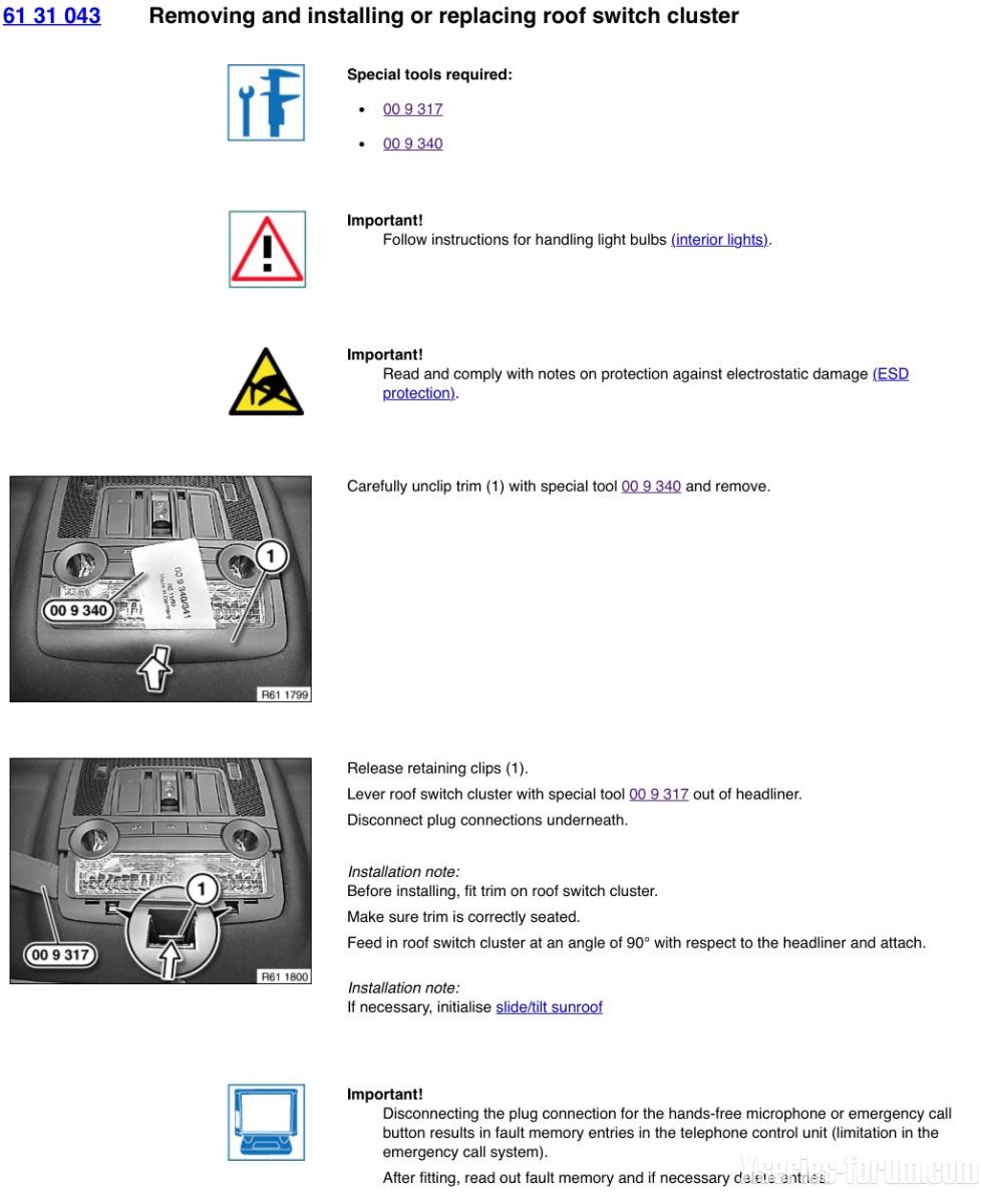

Managed to find this under the switch cluster instructions. Not even mentioned under the lighting sections! Note the special tools are just plastic trim removers. The first is a wedge type and the second look like credit cards. If you have one, wear an anti-static wrist strap, if not make sure you regularly touch an earth or piece of metal of the body. I don’t think the eCall system works any more as it may well be 2G or 3G only. It was routed via Vodafone in the UK.

Post by sapphireblack » Tue Apr 15, 2025 6:24 pm
Many thanks, i actually figured it out and discovered why one light wasnt working, the twist fitting bulb holder is missing 😯 So I'll need one of those which might be fun locate.

Post by sapphireblack » Tue Apr 15, 2025 6:31 pm
X5Sport wrote: Tue Apr 15, 2025 6:08 pm Managed to find this under the switch cluster instructions. Not even mentioned under the lighting sections! Note the special tools are just plastic trim removers. The first is a wedge type and the second look like credit cards. If you have one, wear an anti-static wrist strap, if not make sure you regularly touch an earth or piece of metal of the body. I don’t think the eCall system works any more as it may well be 2G or 3G only. It was routed via Vodafone in the UK.
:D special tool #1 looks like a credit card.
Where did you find that, TIS? Id also like to see the instructions for the two rear lights if thats possible?
I find this all quite odd, when i did the X6 the front cluster popped out whole without great effort, i didnt even realise that there was this cover trim to even remove first, supposedly.

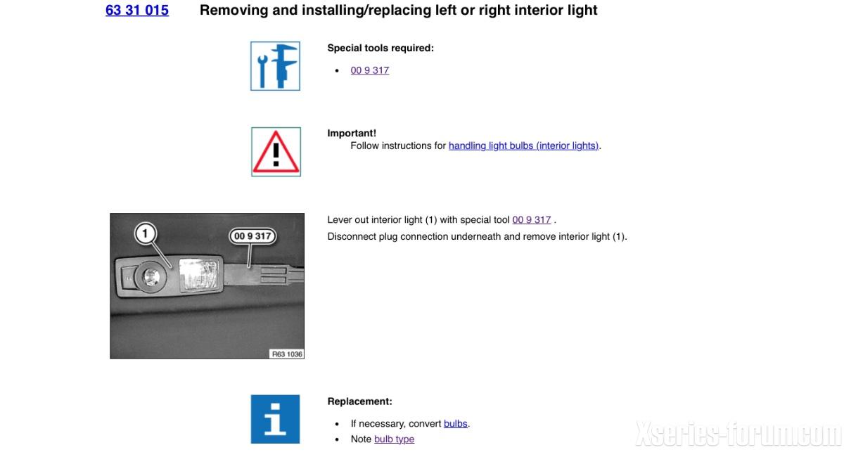

Post by X5Sport » Tue Apr 15, 2025 6:41 pm
Old copy of the TIS. I’ll see what the rear light comes up with.
EDIT: These lights? Same wedge too used. Two lamps according to the good book, both are twist type.

Post by sapphireblack » Tue Apr 15, 2025 6:48 pm
I am very grateful :thumbsup:

Post by sapphireblack » Wed Apr 16, 2025 6:00 pm
Well the later TIS for the rear lights seems inaccurate? Its not rocket science effort to prise on the light fitting as indicated, but the one side i tried wouldn't budge. Im wary of breaking things, nothing BMW badged is cheap.
