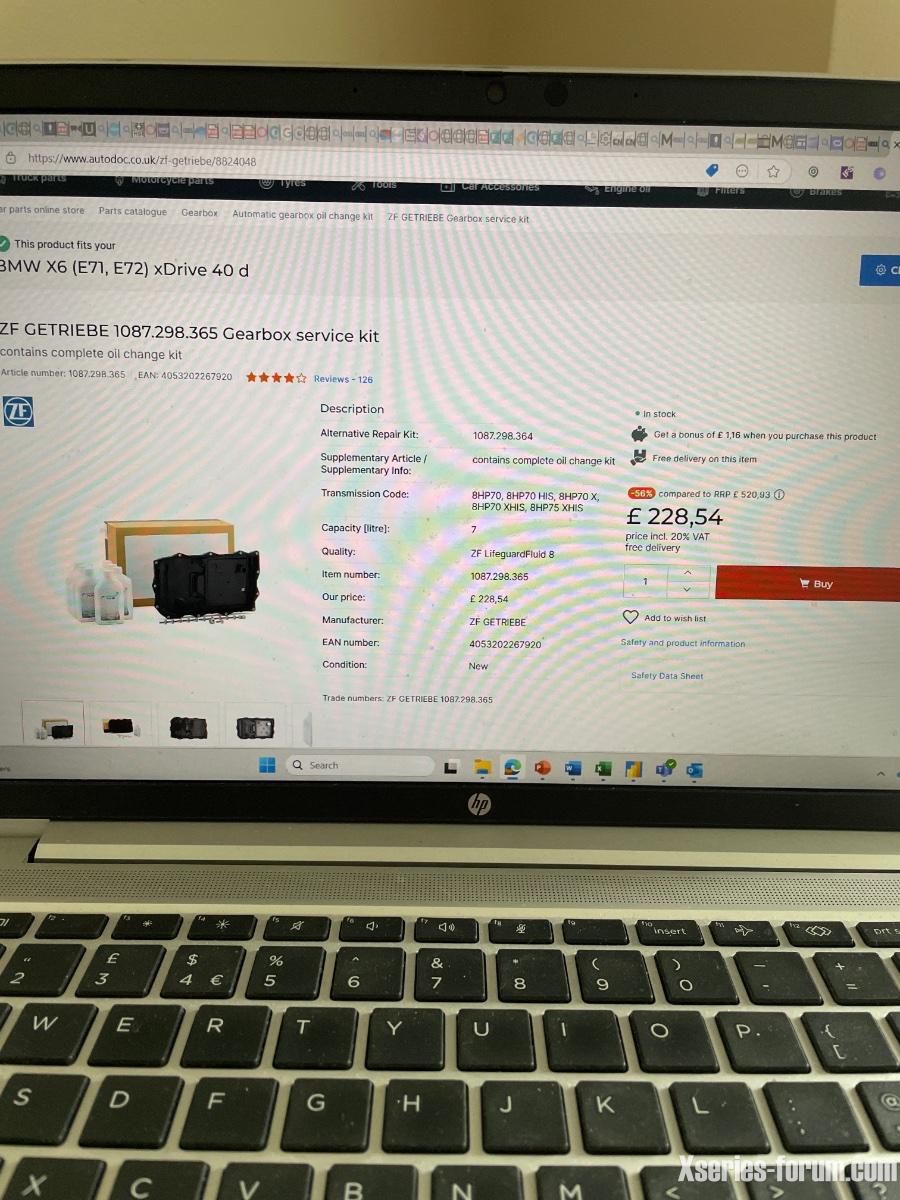

X5sport,
When you were talking about the transmission fluid change, you mentioned a kit, I have seen there is a ZF kit advertised on AUTODOC with the transmission fluid and the oil pan for less than £250, it says it’s suitable for this model. I’m going to get the garage to do it but wondered if worth buying one of these kits and just getting them to do the work?

Sounds about right. Good price too. Mine was £1k but that included front/rear diffs and transfer box. Mine was done by a BMW Specialist in Bletchley (Milton Keynes). He charges about £100/hr, much less than BMW - assuming you can find a main dealer who would even do it. There’s a specific sequence and set temperature needed to change the transmission oil. It’s not difficult, but you need to be able to read the tx oil temp.Pjwmhere wrote: Tue May 27, 2025 3:56 pm X5sport,
The transfer box drain and fill is a pain as you have to get a structural cross member out of the way and support the gearbox. The car was obviously designed to be built, not serviced!
