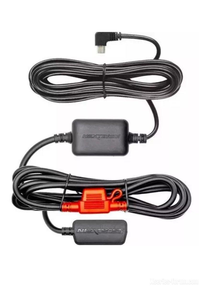

That said, ideally i need a lead with right angle connection to the camera, which only comes in an £18 kit. Having discussed that with Nextbase, they suggest for £20 this is available, making life very much simpler. Its a plug n play OBD connection.

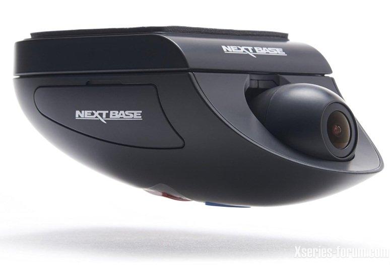

Thanks again. It looks like I'll have to buy a genuine Nextbase wiring kit anyway. The camera i have is new /sealed but only has a straight plug connection, but it needs to be their right angled type.
As the hardwire kit is only a few pence cheaper than the OBD kit, i may end up going for that after all.
The camera is their 380GW, its tamper proof but stylish (imo) and aimed at fleet owners and commercial users. I was stupid to leave one in the 'Greek' Touareg, or i wouldn't need to be buying anything :roll

Oh well, it will be fully hardwired after all. Found a seller on eBay with a genuine, still sealed box hardwire kit at a good price.
