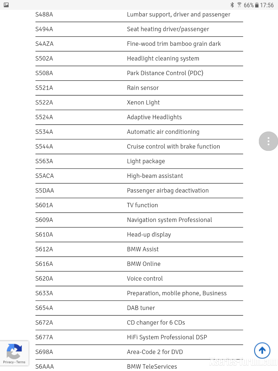

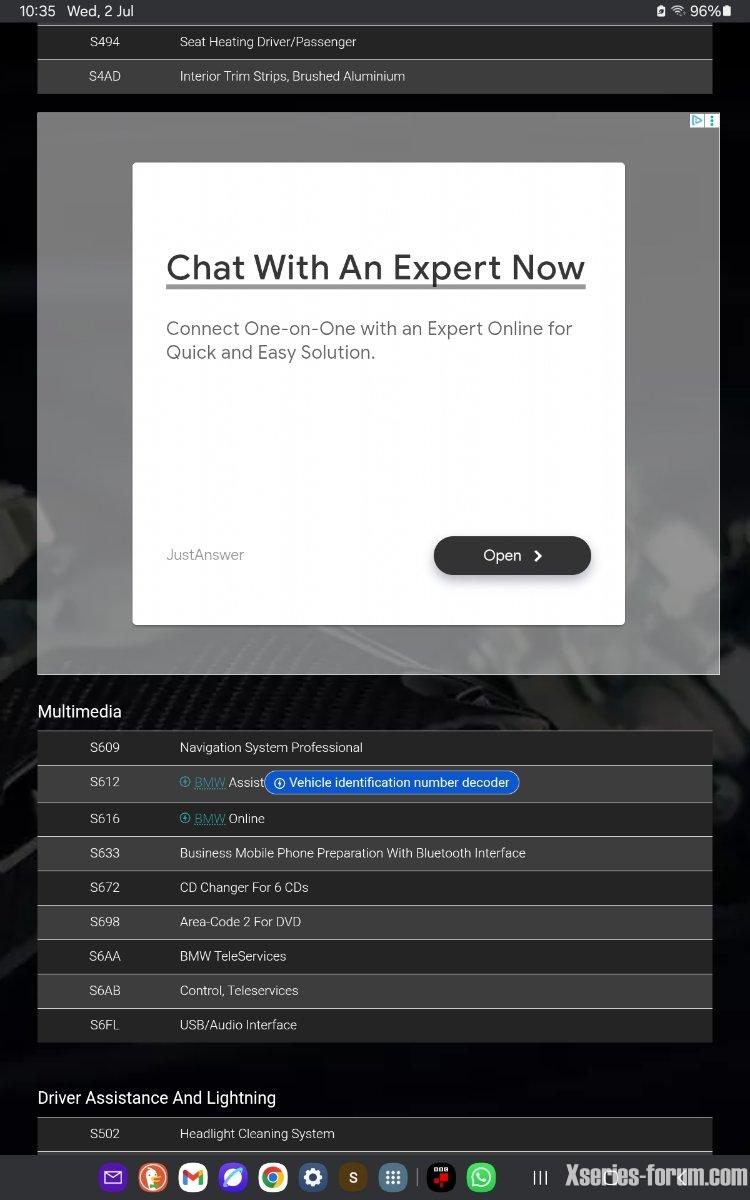

Well the US spec LHD comment from the dealership did make me smile, misinformation at its best.
I didn't think to compare both build specs and unsurprisingly, the E71 has voice command.
The E70 as I've said previously is basically poverty spec. The inaccuracies on the E70's build confuses me though, but for sure S620 is absent. Engine code is M57N2
At least i wont have to go fault finding for something that isnt there at all.

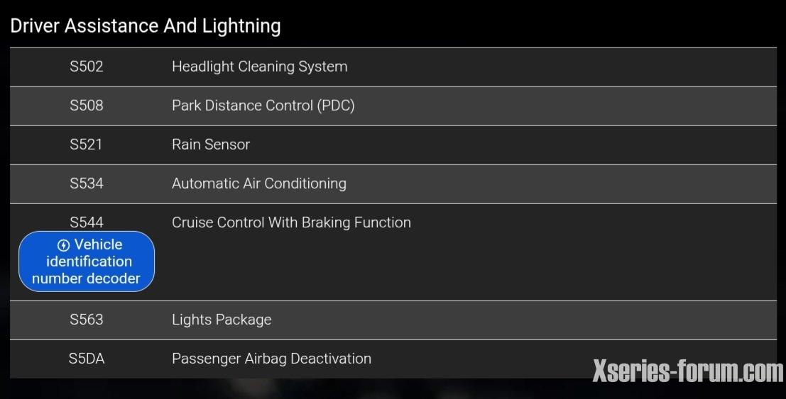

I am scratching my head now in relation to headlamp washing. I've activated the screen washer countless times to properly set up a replacement jet. At no point did the headlights get wet. I wonder if the bumper jet covers can be lifted manually, just to see what, if anything, lurks underneath them. If there's a buggered motor, it will stay that way. Having had the E71s washer tank investigated at a main dealer, I'm in no rush to invite another £300 + bill for the ridiculous strip down required to access the water tank
And confirmation that headlight washers are shown on the build.
[attachment=0]Screenshot_20250702_205617_Gallery.jpg[/attachment]
