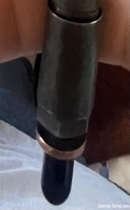

Post by DeeNuttyDJ » Thu Jun 06, 2024 1:28 pm
Done that already, bottom part still firmly in there
Pic for attention showing new injector so you can understand what’s stuck

Car stalled, black smoke Fuel injection on dash
Post by Leslie » Thu Jun 06, 2024 5:26 pm
That being the case you need to screw it back on again and get a slide hammer that screws on the top to remove it :thumbsup: Its carbon build up holding it in .
Im not sure what the thread is but something like this ( I dunno if this is correct one )

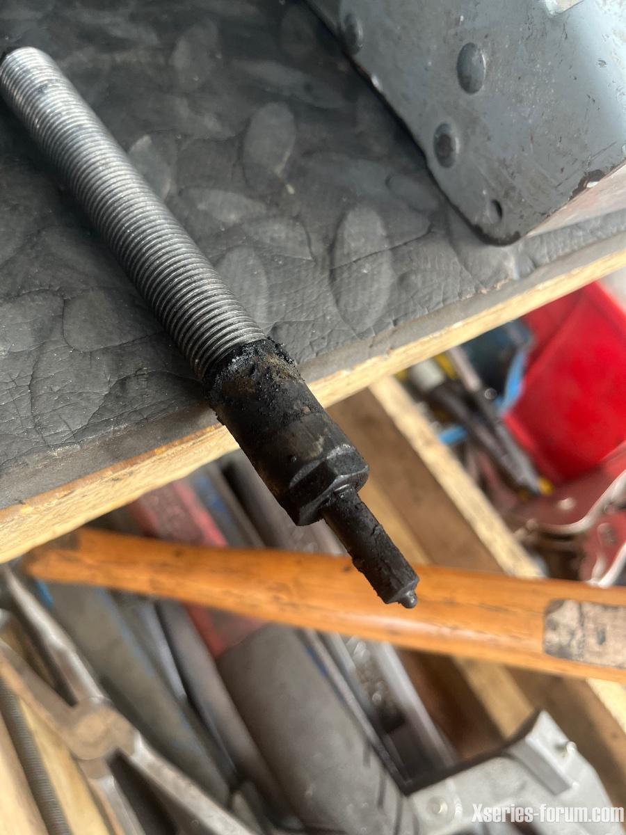

I’ve got the full injector pulling kit .
However I think half the issue was ( the injector did go bang ) which makes me think that it’s blew the threads away and got worse over time, hence the reasons that bit stuck, I’ve got a pal who breaks these cars who’s trying to find a bolt or something that will thread onto it as a last resort, or not I’ll have a pro out to remove it one of them things it’s been left sitting in carb cleaner over night gonna try again in morning, if not going to try some good old mr muscle. If that don’t work I’ll have to pay someone to remove it

Post by Leslie » Fri Jun 07, 2024 9:31 pm
I watched this video it was impressive how they got the last injector out after it sheared in half due to being rusted in. If you can get a bolt to screw into that thread on the lower half you should have a decent chance of getting it out with the slide hammer tool , even buy the correct tap to recut the thread .
Other than that you need a pro to have a look usually its the body that sticks once its free it comes out easy enough , no idea how those 2 could separate unless its split somehow :|
After all the carb cleaner id give it another go on the starter just incase its ready to go now :D

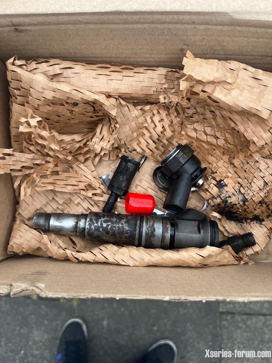

Post by DeeNuttyDJ » Tue Jun 11, 2024 9:01 pm
Good evening everyone
Update !
So I tried everything possible to remove it. Ended up calling in the pros.
Finally out new injector is in coded and running perfectly
