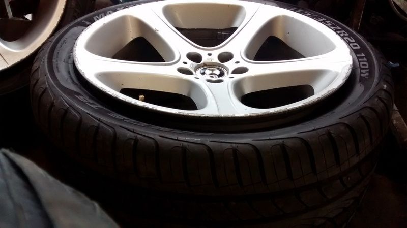

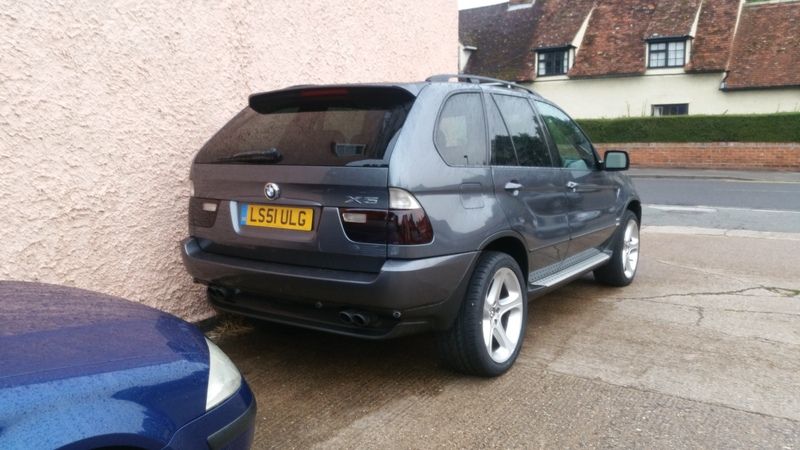

How it started out stock style 87 IS wheels

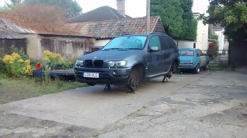

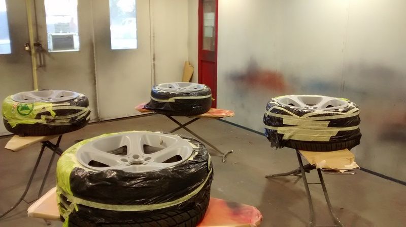

First had to whip all the wheels off so found a place out the way to leave it:
Then first thing was to pop the front bead back so I have access to the whole rim and to make masking up easier:
Next was to clean up the curb rash and to fill the worst of it before keying them up and priming.
And this evening straight after work the booth was free so I jumped in and got to it:
Masked up, primed and cleaned ready for paint:

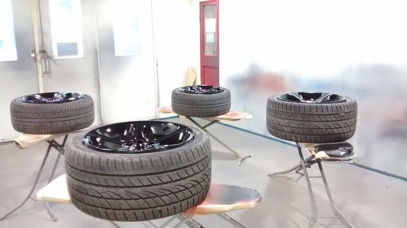

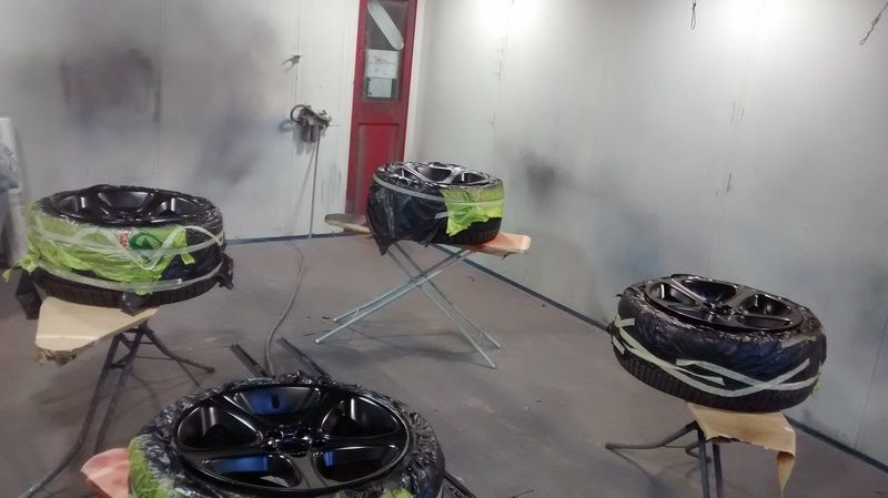

Black base coat laid down:

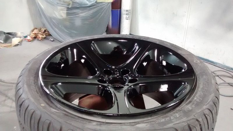

followed by the best bit clear coat:
once the clear coat had been laid down I set the booth to bake at 60 degrees for 30 mins and left them in the booth to fully harden over night and I'll be in work tomorrow morning at 6am to finish them off with the brand new centre caps that arrived from BMW today and whack them back on the car and take some final pictures.....

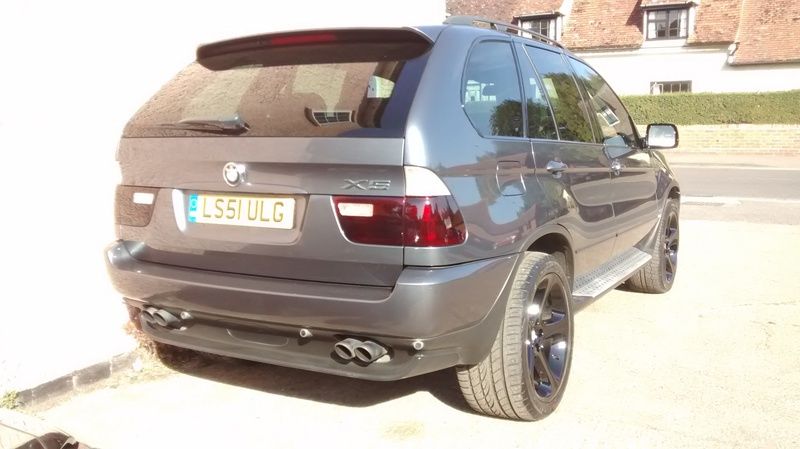

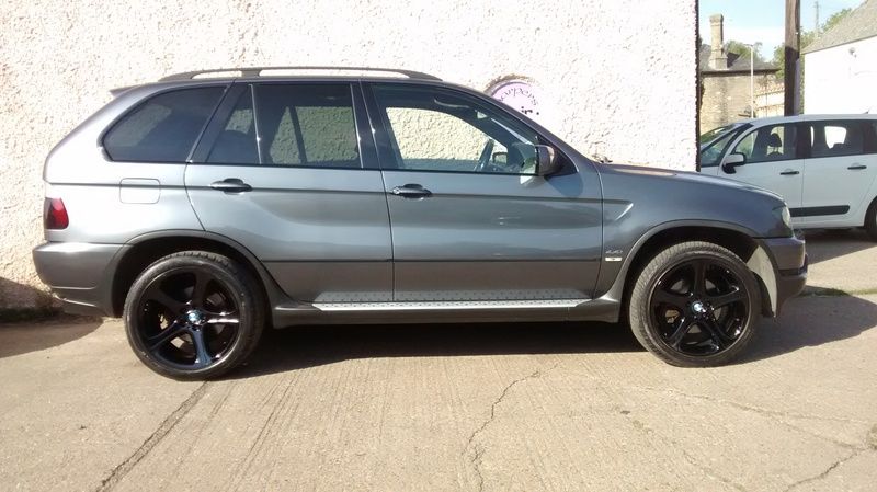

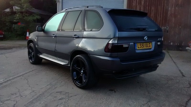

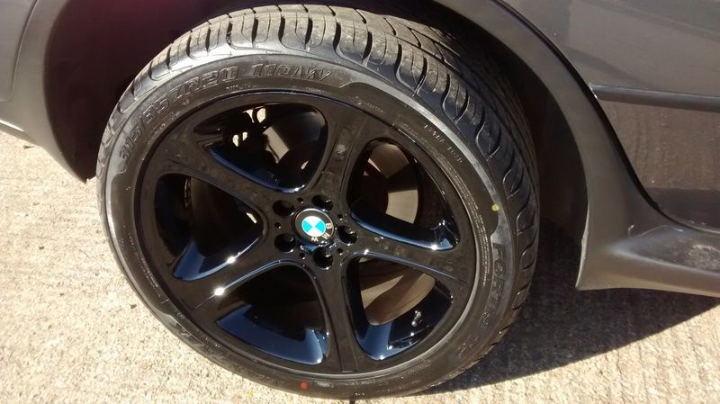

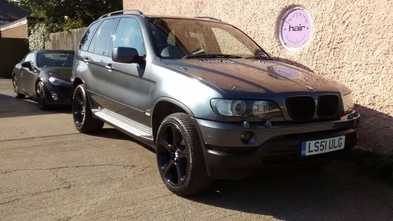

Well there on and I love them in the sun there so reflective being gloss black, hard to get the camera to catch them but I did my best:
