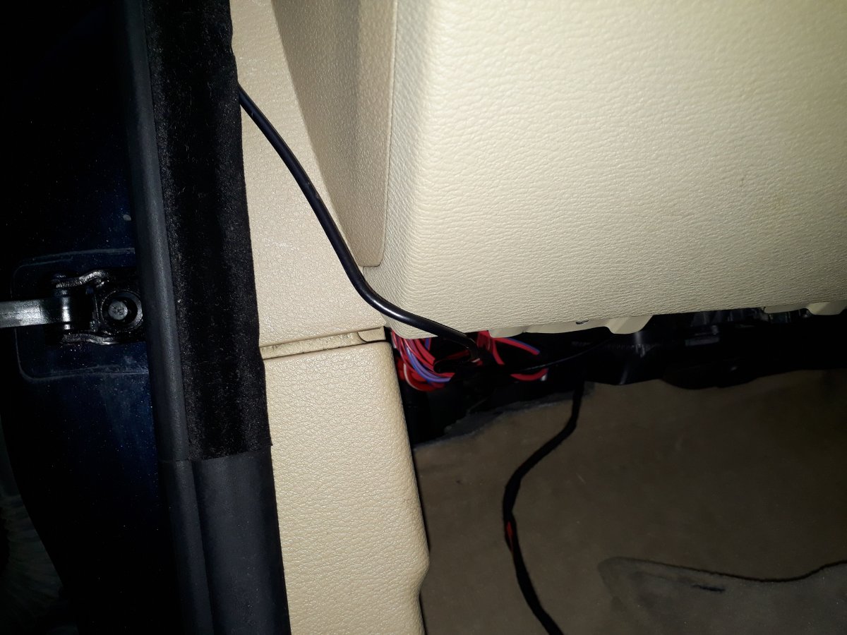

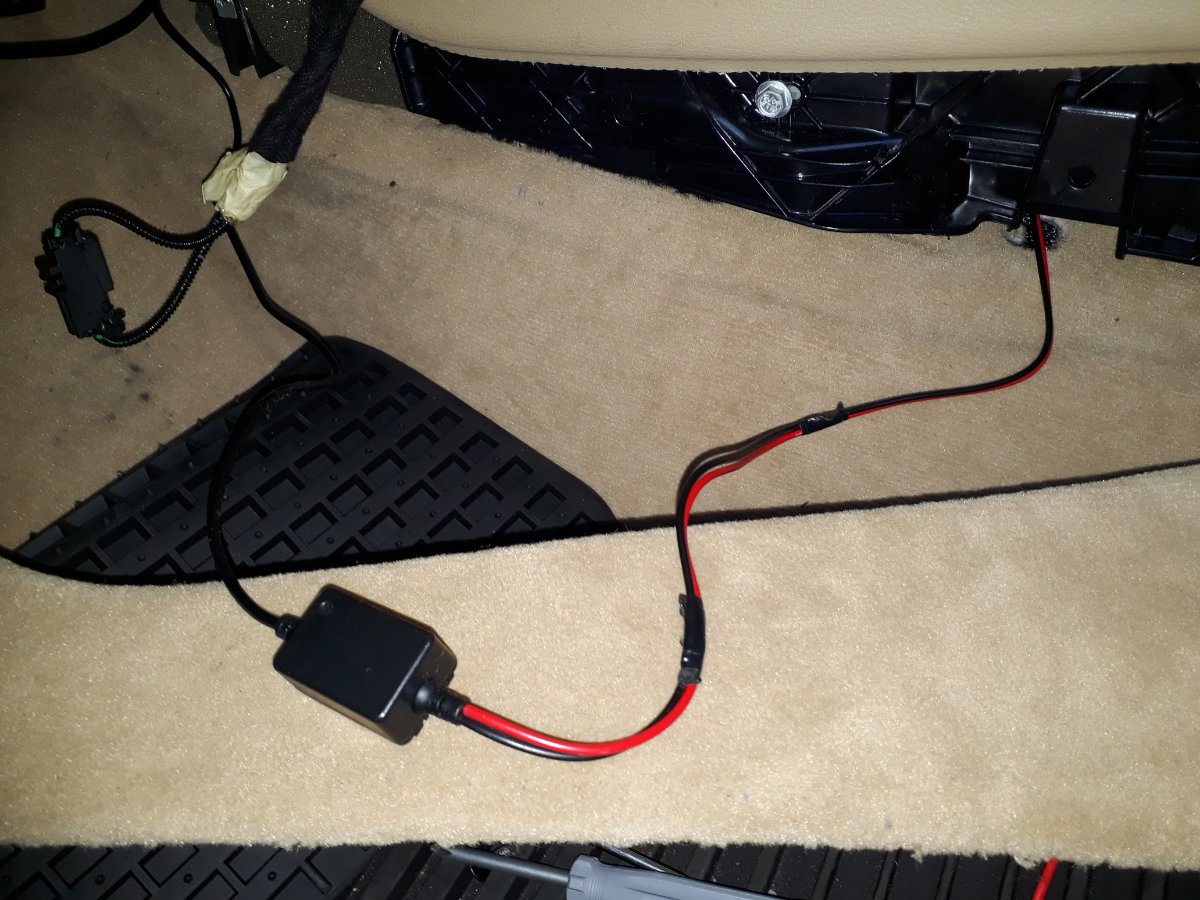

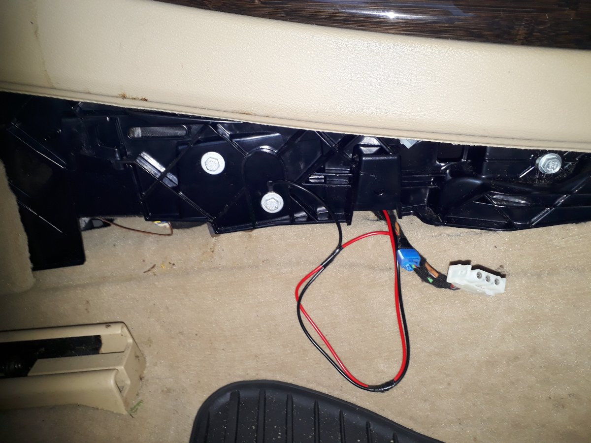

I fitted my dash cam today , after looking at you-tube I was sure it wouldn't take too long ( I was wrong lol) and Id be able to tap into a fuse in the passenger foot-well fuse box , well all these fuses are live all the time , I even left the car locked for 20 mins and the dash cam was still running so a no go !
My hard wire kit was 3m long and would have struggled to get the the rear fuse box so in the end the only option was past the fuse box in the passenger side under the center console and tap into the cigarette lighter wiring ( middle pin of 3 pin connector is 12v which does shutdown with the ignition and there is a handy M10 bolt that screws into a metal bracket that mounts to the floor pan for an earth connection .
The 2 carpeted trim strips either side of the center console are held in with a single torx screw , 2 pop in clips and then they side towards the front to unhook .

I went along the headlining down the pillar airbag then down behind the door rubber , across under the fuse box( 3 star screws to remove ) , along and then under the center console trims to the drivers side where I spliced into the cigarette lighter loom plug with a scotchlok connector .When its all done you can't see any wires .The console side trims need a torx screw removing ,one for each trim.
