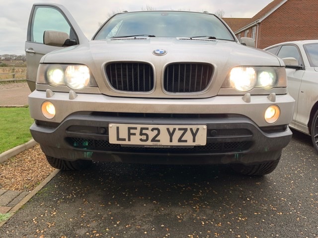

Bit late on this one as I only just got myself an e53 for the winter but this might be helpful for those of you wondering what bulbs to go for in the future.
My factory dipped beam xenons were very dim although a decent white colour. The halogen high beams looked markedly different -twice as bright but very yellow.
So I swapped both for Osram night breakers. Hb3 halogens on the high beam and d2s xenarc on the dipper xenon hid lamps. What a difference! Literally night and day.
Now both are a similar colour and you can see the old halogen dogs for comparison. Not cheap but then you get what you pay for, and I hate blueish looking headlights so these are spot on.

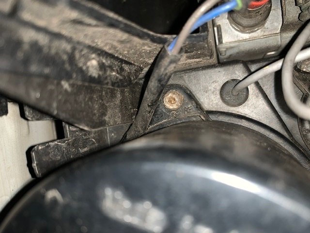

Also a pic of where the bottom t20 screw is to uncover the xenon connector. A bit of a pain to get at but not as bad as YouTube had led me to believe. Whole job took half an hour maybe this first time.
