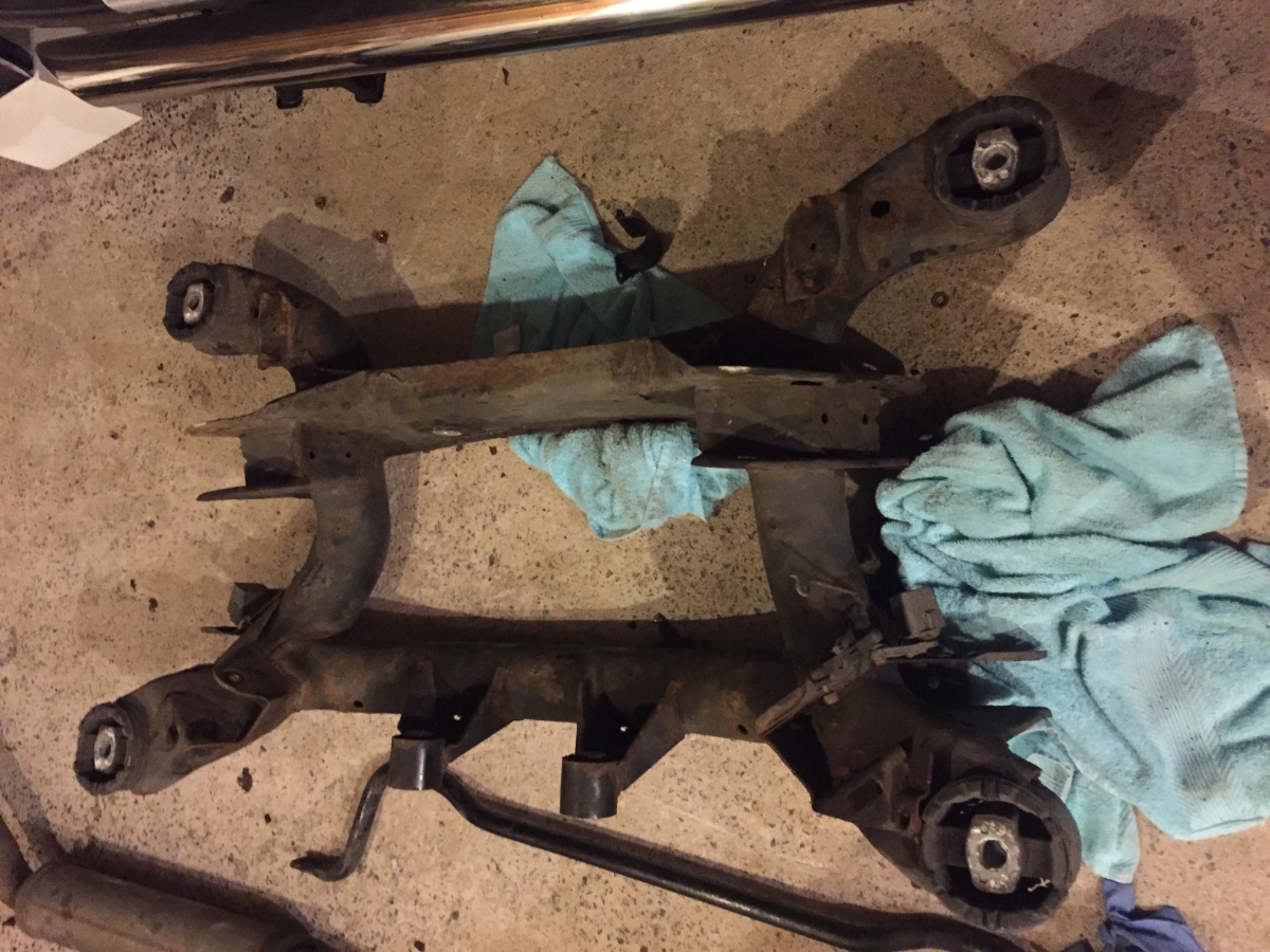

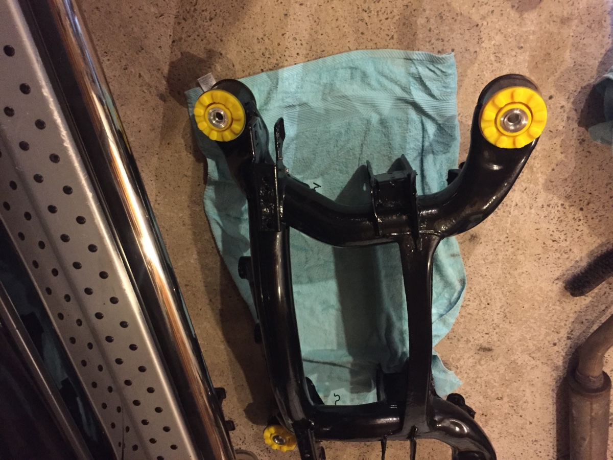

Post by henrym3 » Thu Nov 15, 2018 6:11 pm
Out with the old and in with the new, well refurbed.

Nice one Henry. I did not have the tool and had it done by a garage when I had the rear bushings done.

That's made a nice job of it , I did notice quite a bit of rust on my e70 rear subframe and it isn't even 10 years old yet , don't fancy taking it out but will maybe apply some waxoyl to stop it getting any worse.

Nice job that pal

Great job Henry now you have cracked it the next one will be even quicker. Sooo if I were passing by??

As you can see the mounts are polyurethane and just fit in by hand, I’m a fan of the stuff and every bush on the X5 is now polyurethane. There was other little faults that showed up when the subframe was removed, the area around the diff breather was quite oily, caused by the breather rubber pipe being trapped between subframe and body. A stupid little 10p clip was broken allowing the ride level sensor wire to move about and had rubbed through wire coating and presumably in the not to distant future I would have had problems with that, broken exhaust hanger.
