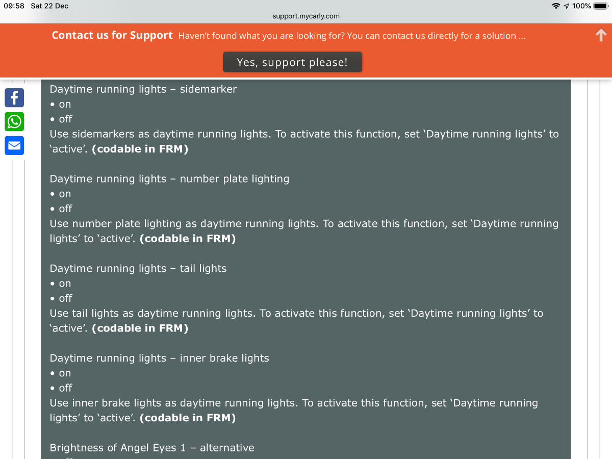

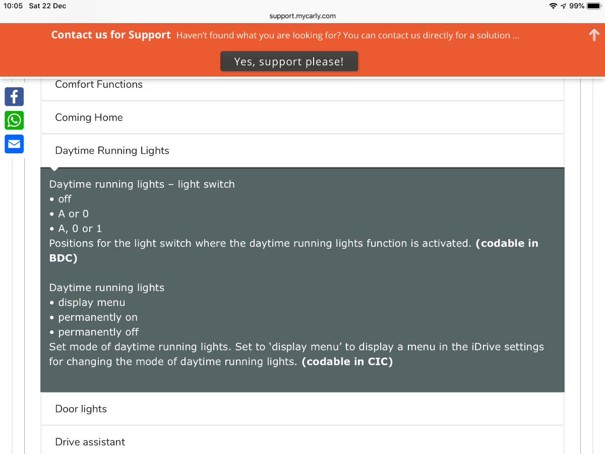

Yes
It’s possible with Carly though I believe you need the full version
snrbrtsn
Posts: 449
Re: Rear lights on with the Daytime driving lights.
Post by snrbrtsn » Sat Dec 22, 2018 10:05 am
EDIT - Sorry, I was looking through the E70 menu, don’t think there is the option yet for the F15
