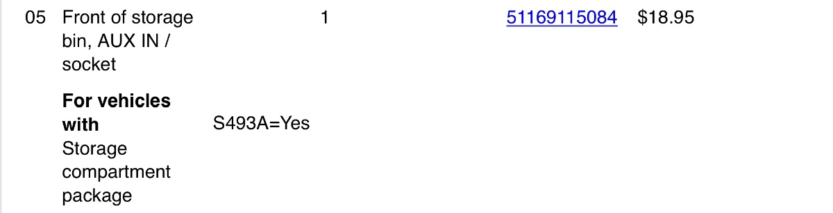

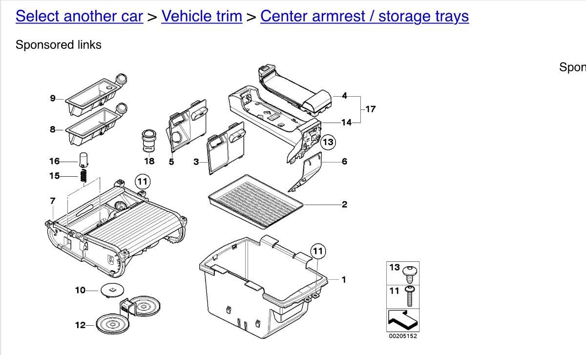

The picture below shows the panel that requires changing to allow fitment of power socket
However, I’d still be inclined to get a USB extension, from glove box to armrest
You will have to check & confirm the part number
Then it’ll be either connecting the wires or running in a positive and negative feed, the centre console wires can be piggy backed, otherwise, directly to the fuse board under dash
