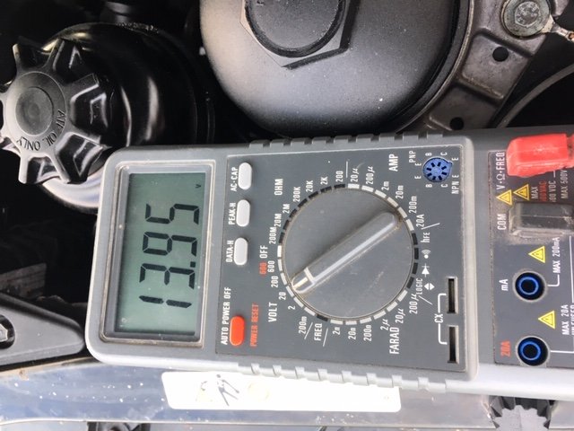

I then thought I'd see if the battery was getting charged when running, meter reading 13.9v when car just ticking over, I think that's ok.

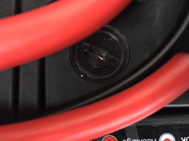

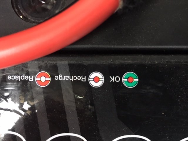

Fully charged and with the car asleep you should be seeing at least 12.6V. You will need to leave it for 4-5 hours after last use/charging before you measure it. A brand new, fully charged battery could show as much as 12.8V (AGM Type). I measure under the bonnet so leave the bonnet open enough to avoid the alarm switch and just lock the car.
Anything below 12V with the car asleep indicates at least one dead or dying cell. My X6 battery died without warning a couple of weeks back. It was falling to 11.5V after a couple of days without use. That one was 8 years old.
If it's an AGM type battery then you should be seeing 14.4V with the engine running at a fast idle and everything else switched off. A badly depleted battery will pull that down though.

No date on battery, but I did see that the indicator is saying it needs recharging, I'll add a couple of pics to show.
I still can't get my head around the reading when I measured any current draw.
- IMG_2420.JPG (36.48 KiB) Viewed 3353 times
- IMG_2421.JPG (46.69 KiB) Viewed 3353 times
