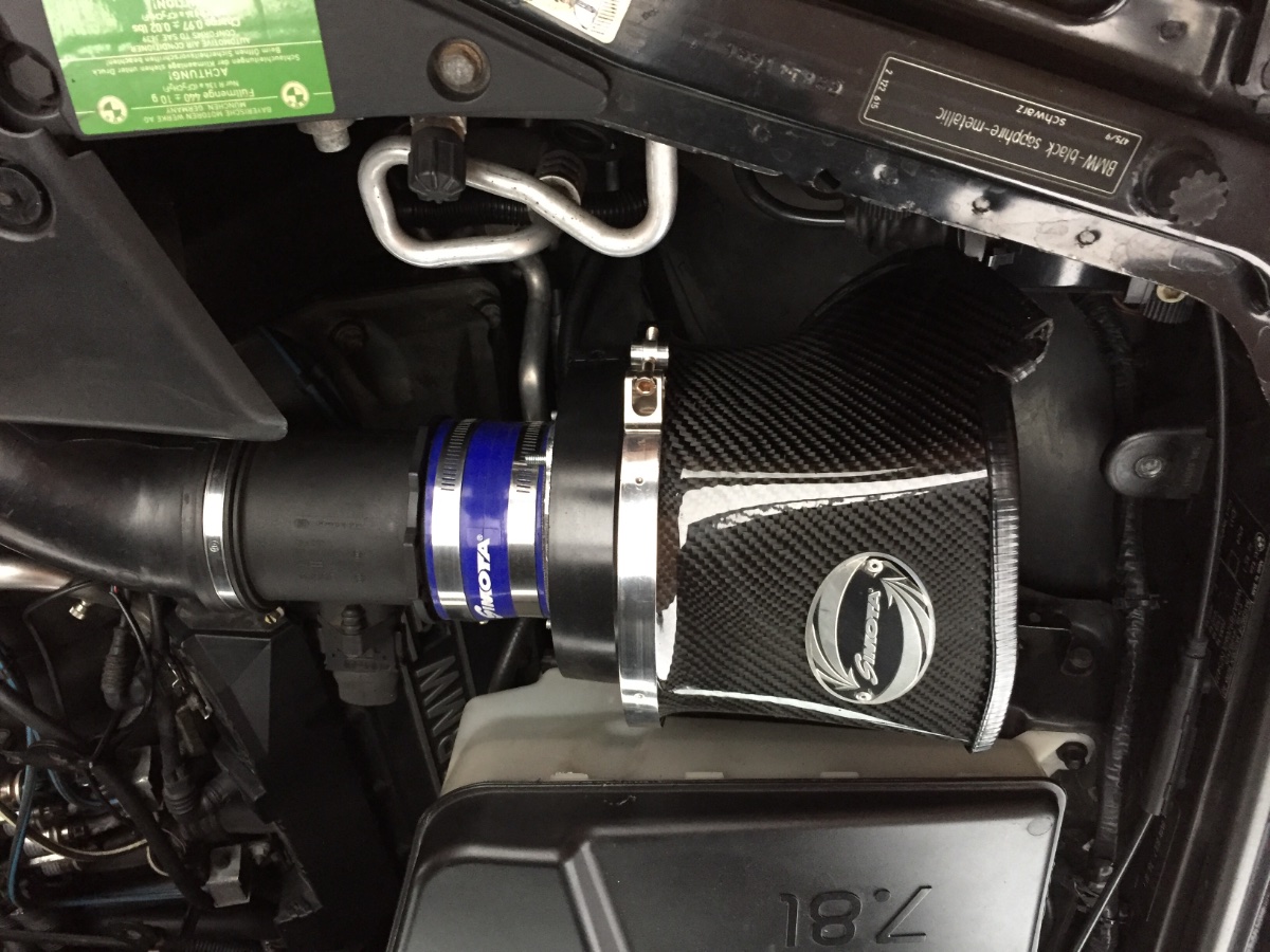

Had this fitted for 3 years now,

That looks awesome!! Does it improve the sound too?

Post by henrym3 » Fri Mar 01, 2019 9:17 pm
It sounds pretty normal in day to day driving, but when you put your foot down everybody knows you have. I have kept the normal pipe that takes the outside air to the standard airbox and it now puts outside air into the area that the CAI draws in.
There’s lots of debate about drawing hotter/cold air in and I monitored air intake temperatures at the AFM before and after conversion. After 20mph the temperatures were the same and below 20mph and idling/traffic jams the temperatures were 2/3 degrees hotter.
