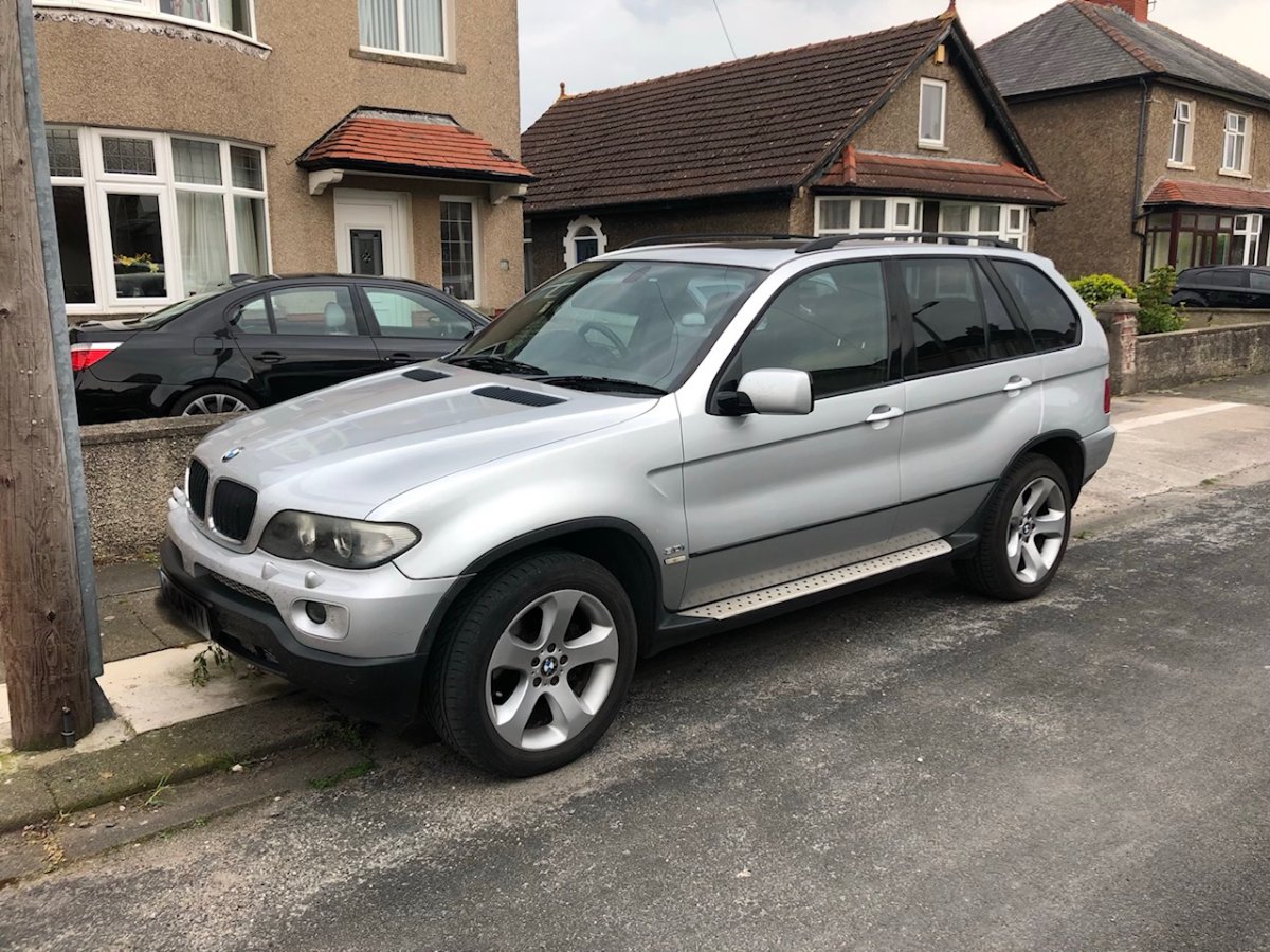

I did forget to put the picture of the old girl up!
