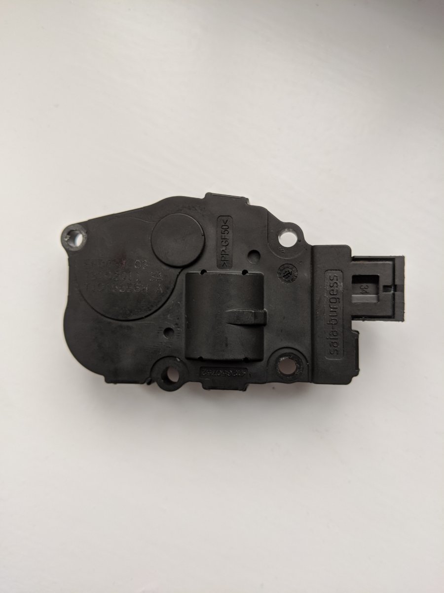

Think I've figured it out.....
So, when you enable / disable recirculation there are in fact 2x flaps that need to open/ close to dictate whether the air is taken from outside or inside the cabin.
You can see one set of flaps when you pull off the cowl under the passenger side bulkhead to replace the external pollen filters - I can see that one opening and closing nicely when I fiddle with recirc. BUT, there's another flap too, inside the car, between the internal panel filter and the blower, up under the passenger side of the dash.
This is attached to a stepper motor that is easy to get to and held in with 2x screws. Simply remove the ducting as if you were to get to the interior filter, and you'll see the motor attached to the blower housing - 2x screws and off it comes. As attached.....
Now the spline that the motor attaches to moves freely as you can move it with your fingers and make the rotating flap that sits between the interior filter and the blower open and close. When I have the engine running and the motor connected to the harness but otherwise in my hand, it doesn't budge - at all, whereas the other one for the flaps under the bulkhead operates quite happily. So we have a dead motor it would seem, which explains why I think the internal flap remains closed when put onto recirculation when the external flap closes too - meaning the fan can hardly draw any air through as both flaps are closed!
Question next is does a new motor require coding in......
EDIT - realised all the stepper motors for blending control are the same part number, so that part below is standard fare - however the fact there is one that works in conjunction with the one for the bulkhead flaps (when those are open this one is closed, and vice versa, which is my problem) is they key here.

Re: e70 Blowers a bit weak?
Have a look at newtis for your version of the E70. The comment I can see is that it states the actuators need ‘readdressing’ if replaced. I would read that as some coding action is needed. It just doesn’t say what.
A chap on here (half way down, called 930rose) got a spare from a breakers from a 3 series, fitted it and it just worked. He's where I got the idea from it might be an actuator, and that coupled with the fact the air flow seems "blocked" when on recirc pointed me that way....
https://www.bimmerfest.com/forums/showt ... 995?page=4
So I've found one on eBay for £11 - ordered it and going to give it a shot. If it needs programming in I'll take it to my local independent
Quick update - given that the replacement motor is from eBay, therefore from another car, fitting it myself was a non-starter.
Plugging it in and leaving it dangling (and starting the car) proved the old motor was dead as this new one started turning straight away which was nice, but it just went round and round so getting it attached back onto the flap control spline was impossible. The system clearly has no clue what flap this motor is trying to control (who knows which flap it was connected to on the donor car), where the start and stop positions are and which direction to turn to do what.
https://www.newtis.info/tisv2/a/en/e70- ... ls/Q40JlZr
So it's booked in with the independent next Tuesday to fit.
