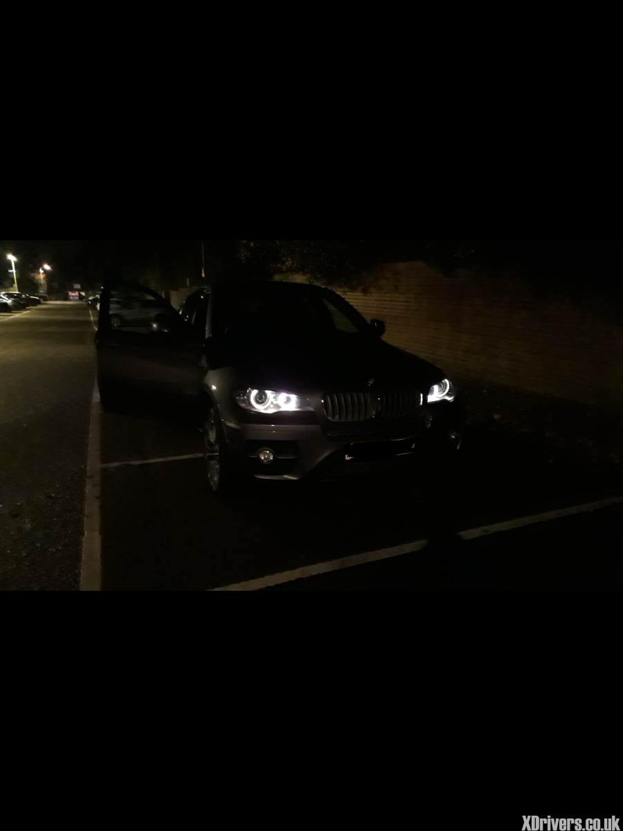

Try hids-direct.co.uk
IIRC these are MTec brand, regular bulbs which are white but no regular bulb will get near the LED output of later models with factory LED systems.
My car with side lights on.

I know the photo is taken in the dark but these look pretty decent. What are they like in daylight out of interest?
I'll take a look on there website and see what they have.

They are still white in daylight but not like LEDs. With DRLs selected on the car, dipped beam is on anyway, but at least everything is white with Xenons.
Does the linked website not work?
