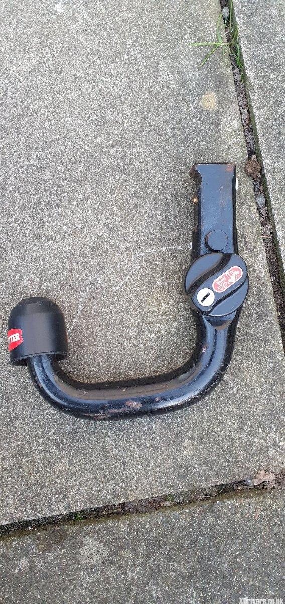

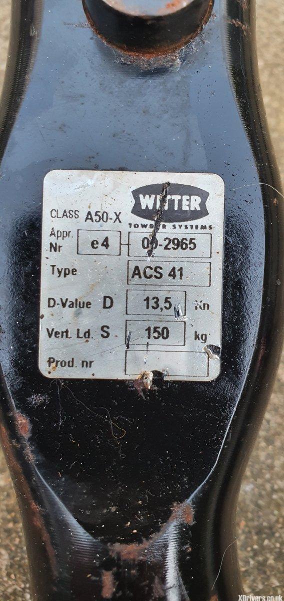

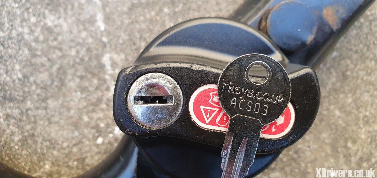

Never had a key for this so ordered from Replacement key company. Doesn't fit. I assume this is the right code.
Witter codes start with TR on their site but barrel code is ACS...soaked in WD40 but anyone familiar with what the right code should be please.

I had an identical problem last year. From memory blue colour locks do have TR codes, mine did. I wasn't aware of a black version but the close up certainly shows an ACS code. I found Witters etched codes illegible so couldnt get replacement keys.
Two keys from Witter were £20, a complete new assembly was around £30. Easier to replace the whole thng if proving difficult. My solution as i dont need the security of the lock was to drill it out. Its just as flexible to use but obviously does now lack any security.
I'd send your images to Witter and seek their help.

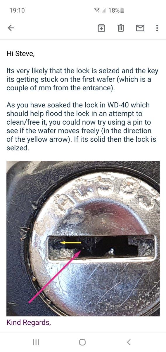

The key company have been pretty decent seeing it was a fiver all in and next day delivery. I shall persevere.
