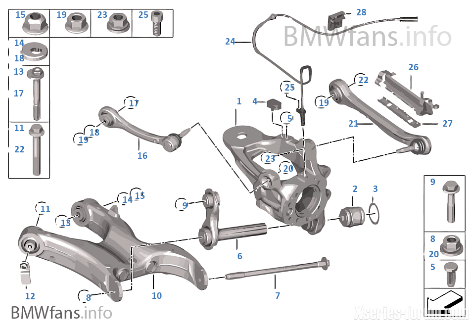

Item 2 in the picture is normally at fault if the excessive tyre wear can’t be brought to within tolerance. To check the bearing the suspension must’ve fully unloaded.
Wayfarer
Posts: 266
2010 E70 X5 3.0d - Inside Rear Tyre Wear
Post by Wayfarer » Fri Sep 10, 2021 6:08 am
Thanks Henry, that looks a fairly complex design with a reasonably easy fix.
