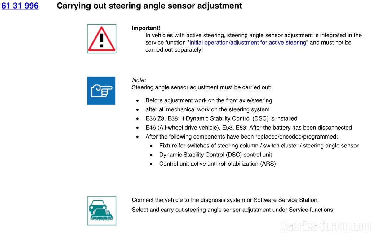

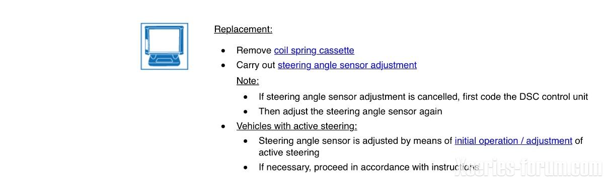

Post by Leslie » Mon Jul 19, 2021 11:50 am
Not done but think it needs calibrated after.

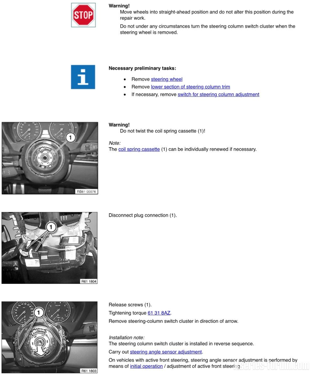

Posts: 18989
2010 E70 X5 3.0d - Fault Code DSC 5EC0 - Steering Angle Sensor
Post by X5Sport » Mon Jul 19, 2021 8:48 pm
Posts: 1943
Post by henrym3 » Mon Jul 19, 2021 9:01 pm
