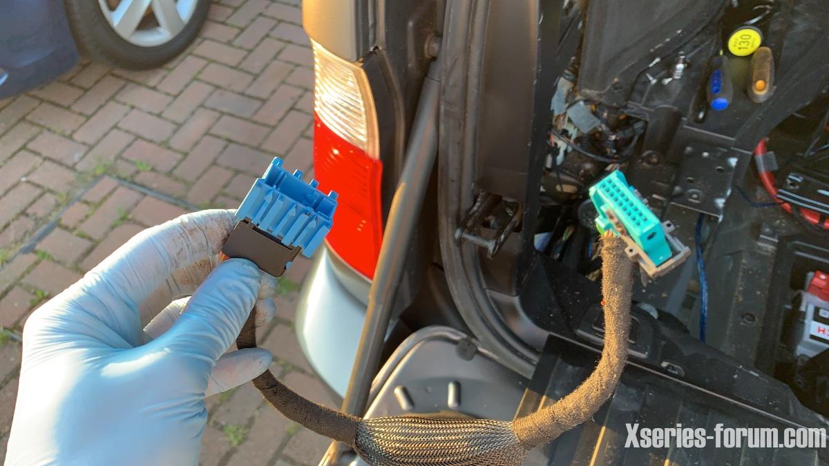

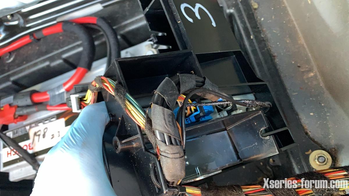

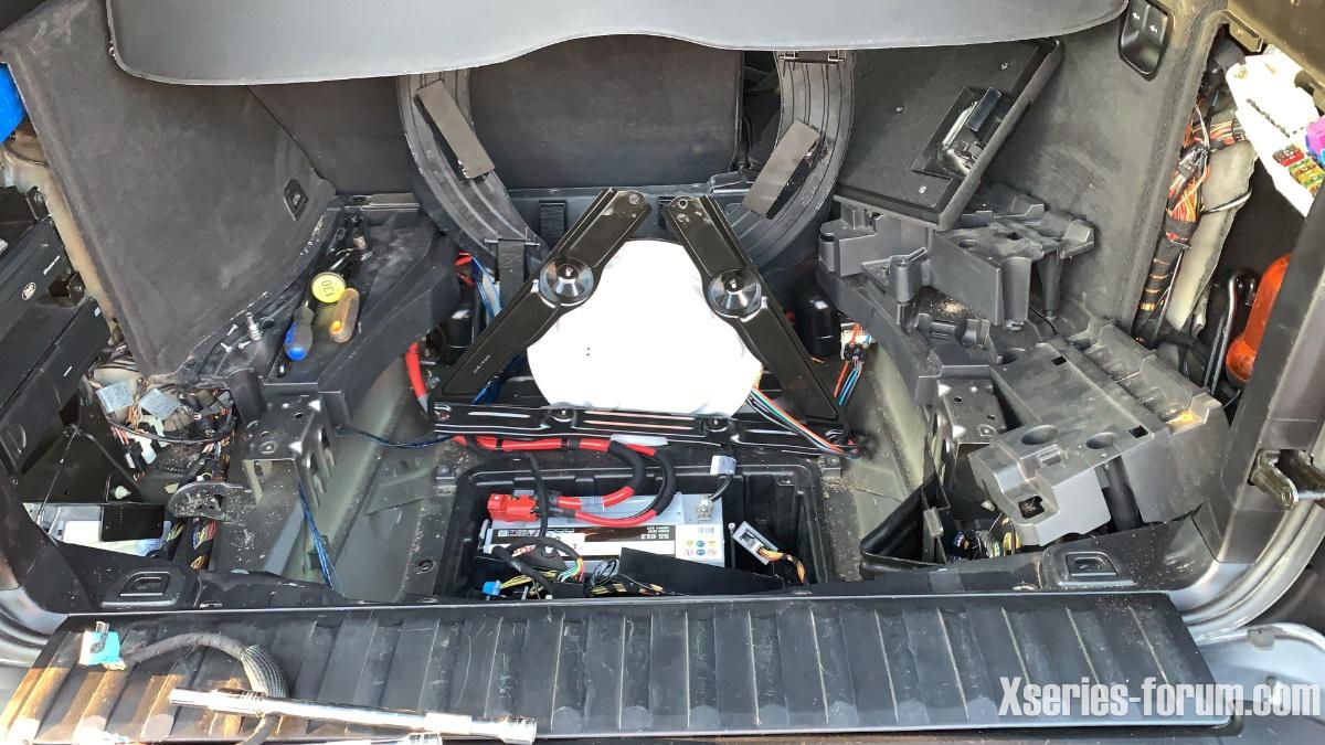

Just a wee update… pulled the car to bits today & had a deeper look into the audio system. Removed an unknown adaptor from a rather large module with a cooling fan in the boot. After it was removed everything returned to normal. Everything works perfectly. Even the steering wheel controls have sprung into life. Put the strange adaptor back in & everything continued to work perfectly.
So yes the problem is fixed but unfortunately I can’t describe how I’ve done it

Well i have no idea what that connector block is either
curious how it reactivated missing things when removed but didnt recreate a problem when re-fitted.
A good result though
Possible LCM problem? (Fixed)
Good job wonder if water is getting in the connector from behind the light cluster and upsetting things

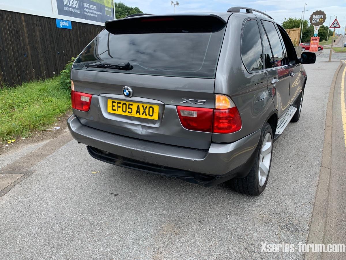

My happiness was short lived as it’s today been rear ended by a tailgater

Oh dear
well at least you'll get a fresh paint job on the rear end, albeit not a desired choice.
Well let’s just say his 2020 Luton van needs a lot more than paint lol. That badly damaged that the passenger door wouldn’t open more than 6 inches.
The E53 is clearly made of some strong stuff!

That's a real shame
Id think there is a fair bit of damage behind the plastic bumper and it will be a writeoff
It’s going in for an evaluation on Thursday with the body shop so I’ll know what’s happening then. When you look down behind the bumper everything looks straight & the bumper is still solid so fingers crossed it’s just the tailgate damage. Which also still functions & fits perfectlyLeslie wrote: Tue Aug 03, 2021 11:58 pm That's a real shameId think there is a fair bit of damage behind the plastic bumper and it will be a writeoff
