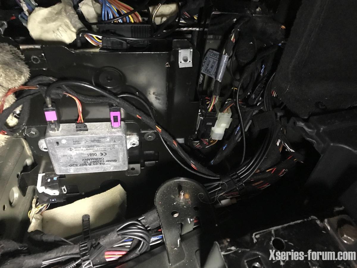

I have some sort of a small box just above the amp with 2 antenna. In fact forget what I said, I’ll take some pics tomorrow and post them and see if you can offer advice

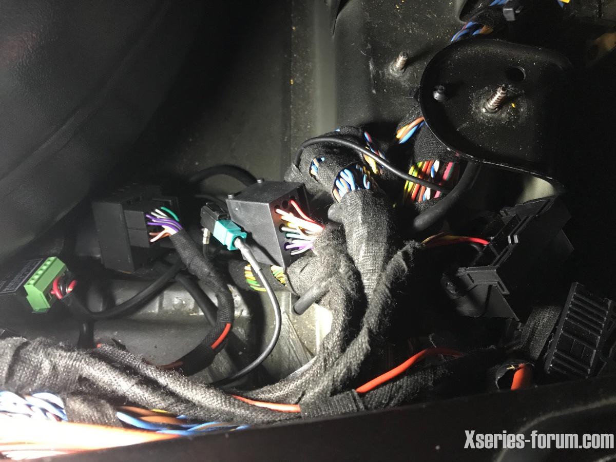

Ok took a few pics
Even unplugged the cable in the boot and no change of sound. On the box where are those 2 leads coming from or going to.

I believe the first picture is Telephone GSM booster (mauve connectors) did your car originally have a phone in the armrest. The second picture the Blue Fakrs connector is the radio antenna
You will need a Fakra to ISO converter (if that is what your new radio accepts) then an ISO Ariel lead then your signal should come from the Antenna in the spoiler.

Thanks for the info, it did have the telephone cable in the armrest which I replaced with an iPhone lead to usb. I’ll fiddle and get back to you. I’m working on the reverse camera atm. It works fine but I had the PDC integrated showing the radar distances on the Dynavin and now with the Xtrons their gone. They are somehow worked of the canbus. Should have payed more attention when stripping the Dynavin out.
