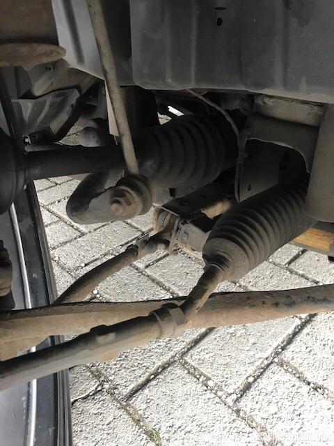

Have to drag this thread up again, after all my praise for the AA. Once the pedal was fitted I had to go into isolation prior to going to hospital to have them poke about at my ticker so never went anywhere. Today I went for some lpg and got 50m and realised my steering is at 3 o’clock to go straight ahead and SAS, DSC and ABS lights are on. Just couldn’t figure why steering wheel was so far out. Quick inspection found that the tie rod on one side was severely bent, I can only conclude the AA man looped the strap over the tie rod as he connected it round the bottom arm.

That's made a bit of a mess hasn't it :headbang:

Post by sapphireblack » Sat Oct 09, 2021 6:18 am
Thats not good :o
Any recourse with the AA, or will it be too late after the event now?
Posts: 19035
AA
Post by X5Sport » Sat Oct 09, 2021 9:55 am
That’s dreadful! New steering rack required? I would have thought that you had a case given you didn’t go anywhere and can show you went into hospital. Any paperwork with the driver’s name on it? If they play dumb then shame them more widely!

Was a serious problem with the Ford Transit as the tie rod from left to right sat behind the front axle and frequently when tow rope was looped over the axle the tie rod was looped as well.
I used to own an Express delivery co. and had several dispute with recovery companies who did this.

A new inner tie rod should see it fixed ,it would only have been used to winch into the towtruck , to be fair most of us are not too awake at 2:30 am and in the dark it was an easy mistake to make :( The mileage will likely have been recorded when it was picked up so that would help prove it hasn't been anywhere to cause damage after towing .

The AA are investigating the issue. As I need to use the vehicle I asked if I could replace the parts myself when they said the investigation could take some time. They agreed and said it would not prejudice the claim in any way. I have ordered MEYLE tie rod and ball joint for each side. £89 I checked prices with BMW and for one side it was over £250. They should be here by Thursday. I fitted the new throttle pedal and all seems fine but will be happier when I can go for a drive.

Just to finish off, track rods fitted, done both sides. I have had to take it to Kwikfit on 3 separate occasions to get the steering wheel pointed in the right direction. The AA have reimbursed me for the full amount without accepting any liability. I suppose that’s standard procedure.
