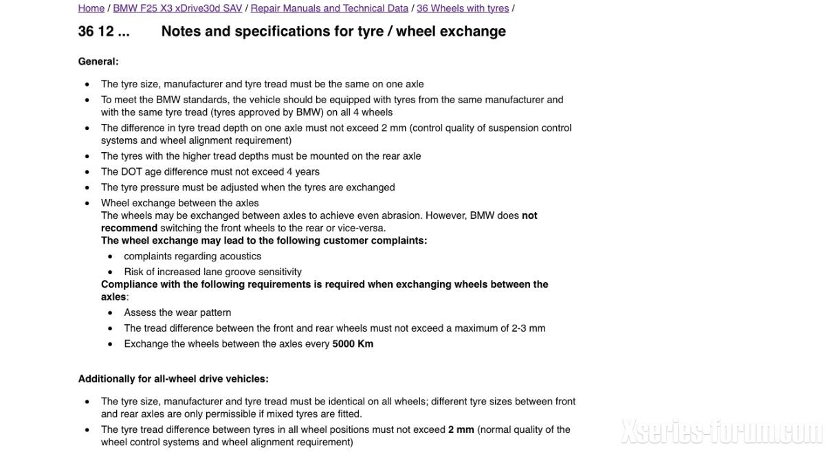

Posts: 18995
changing both tyres on rear axle
Post by X5Sport » Thu Oct 21, 2021 8:44 pm
No more than 2mm between any one tyre or axle and the rest or other axle. 1.5mm is better. The upper limit comes from the BMW Technical Instructions. See below (and applies to all AWD versions regardless of tyre size).
