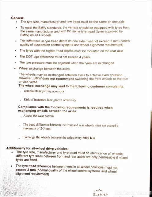

Congratulations on your x5, great spec, tyres are important, BMW say the tread difference between any tyre is 2mm assuming all the tyres are the same make, type and of similar age, this is from the info I got when I recently replaced a tyre, star rated are recommended by BMW to avoid any potential transmission issues. I’ll try and find and post the text when I find it for your info, although someone may post it on here before I find it.

Post by Wayfarer » Tue Nov 30, 2021 6:35 pm
Found it, the tyre info as supplied by by local dealer
BMW Tyre Info .jpg (49.18 KiB) Viewed 14678 times

Thanks for the advice on this and much appreciated for uploading that photo, very useful to myself and probably others.
