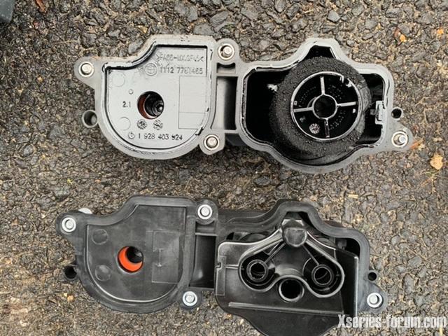

Well the crank case vent was overdue a change. A 20k serviceable item apparently - doesn’t look like it’s been done any time recently.
FSR didn’t fix the heater. Next step is to check the control unit and feed to the blower
Posts: 19041
Hello at last
Post by X5Sport » Tue Dec 07, 2021 8:05 pm
Given that the ‘bog roll’ PCV separator went out of use back when I had my E53, that means yours has most likely never been done. I found our M57 powered E46 still had its original PCV separator and air filter despite always being serviced by BMW until it was about 6 years old (now 16). The air filter was absolutely black and I’m amazed the engine was getting enough air! Been done twice since, even though the car has only done 73k miles since new.

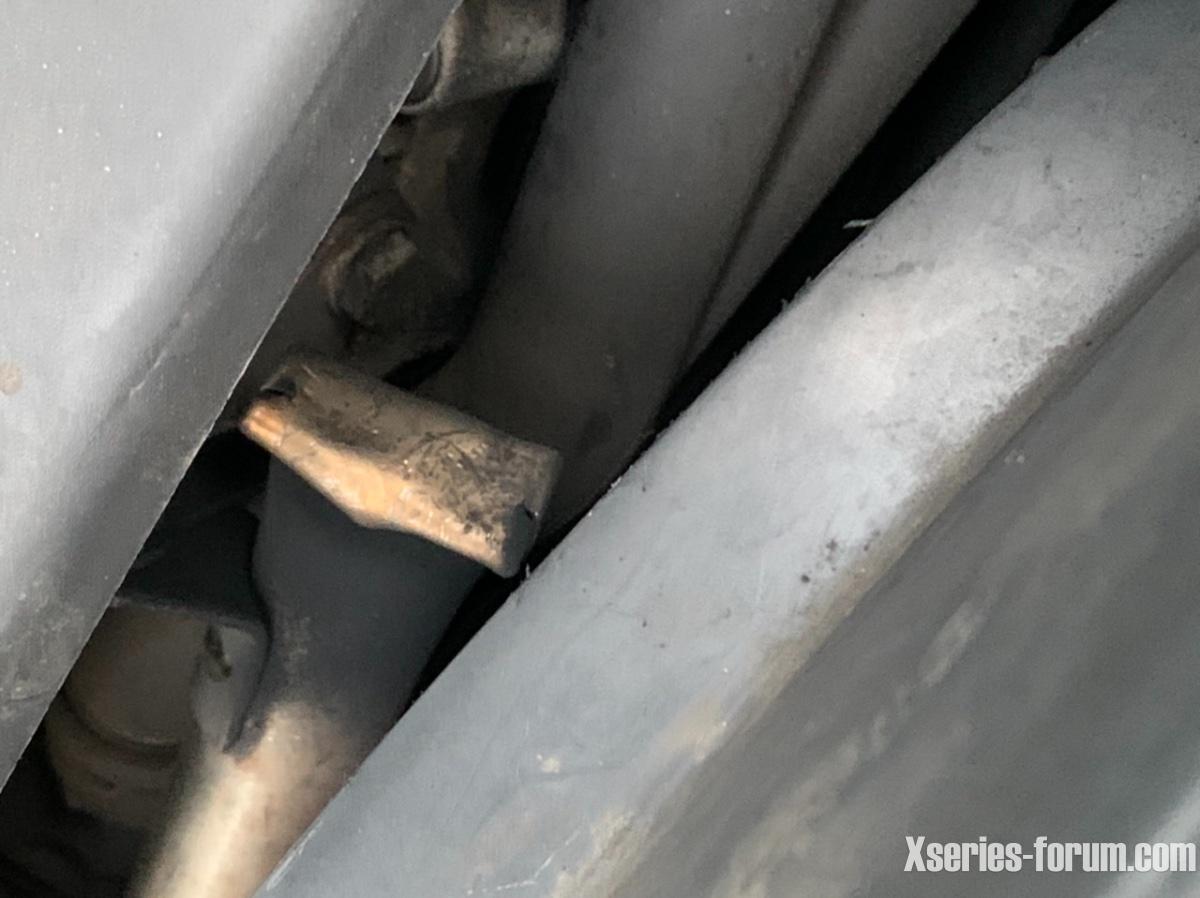

Changed that and fitted the blanking plate (where someone had done the value end but bent the pipe up that half way along). Cleaned up the area which was covered in soot - hopefully that’s 1 problem sorted. Certainly seemed way more eager on the short drive today whereas before it was feeling sluggish. Longer drive tomorrow for a better test
Edit: here is the bodged pipe in situ:

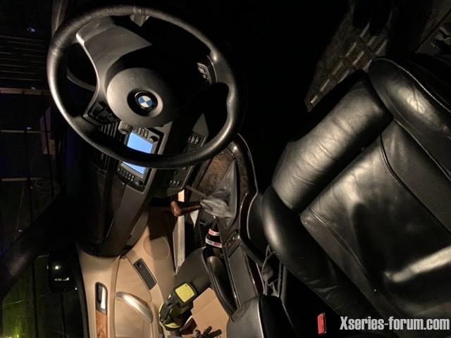

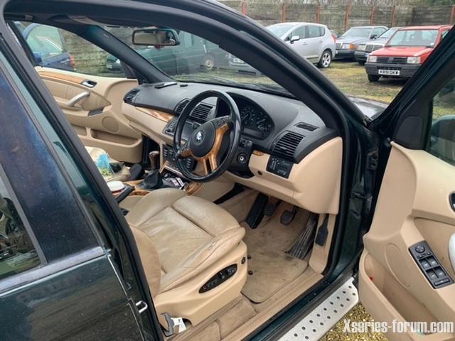

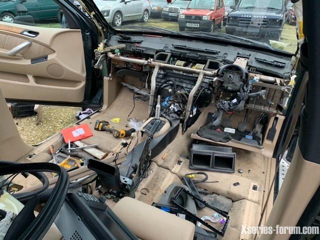

Set myself the challenge of swapping the interiors of my X5s today. Started around 930, finished around 530.
Pulled the Dash out of both cars, installed a new blower in my green one, swapped the carpets, swapped the seats (mine now has heated front and rear seats). Got almost all of it done apart from the door cards and boot area. I had to complete it in order to drive home.

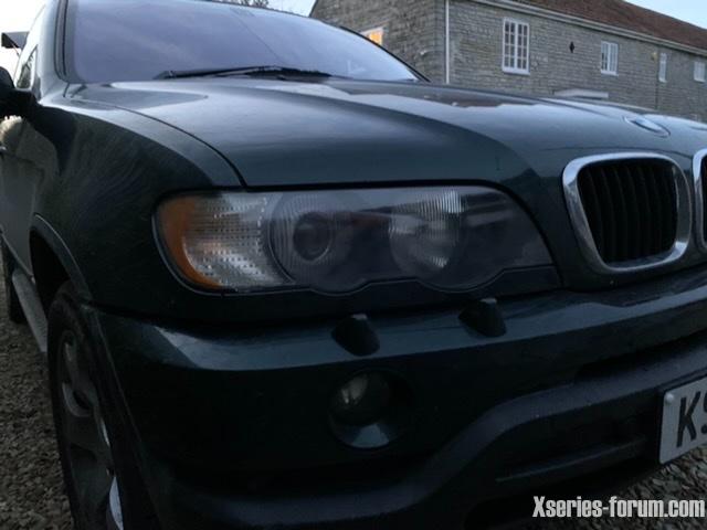

Did the headlights. Not perfect but a million times better - I can actually see now
Before:
After:

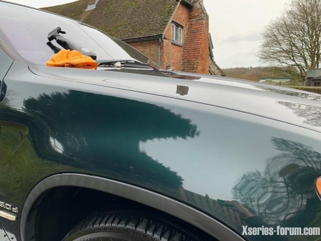

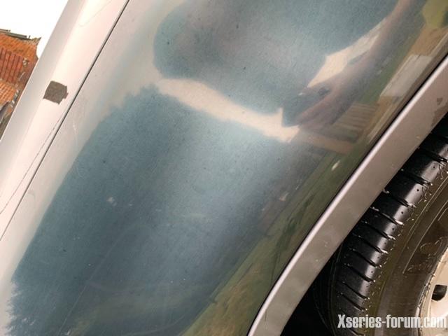

Also gave the car a polish today. Lots of oxidisation and general wear on the paint. Jet wash, snow foam, clay bar, medium cutting paste and a DA polisher:
Before:
After:
