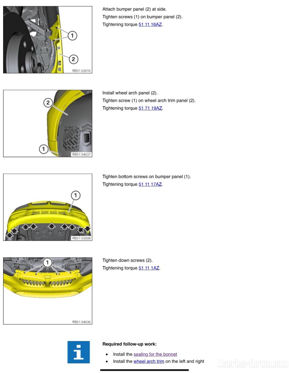

The front sensors don’t need the bumper off apart from left centre. Screws at top (4) and bottom (9) all need to come off Sides are got to via the wheel arches and front right via the trim panels below the fog lights.

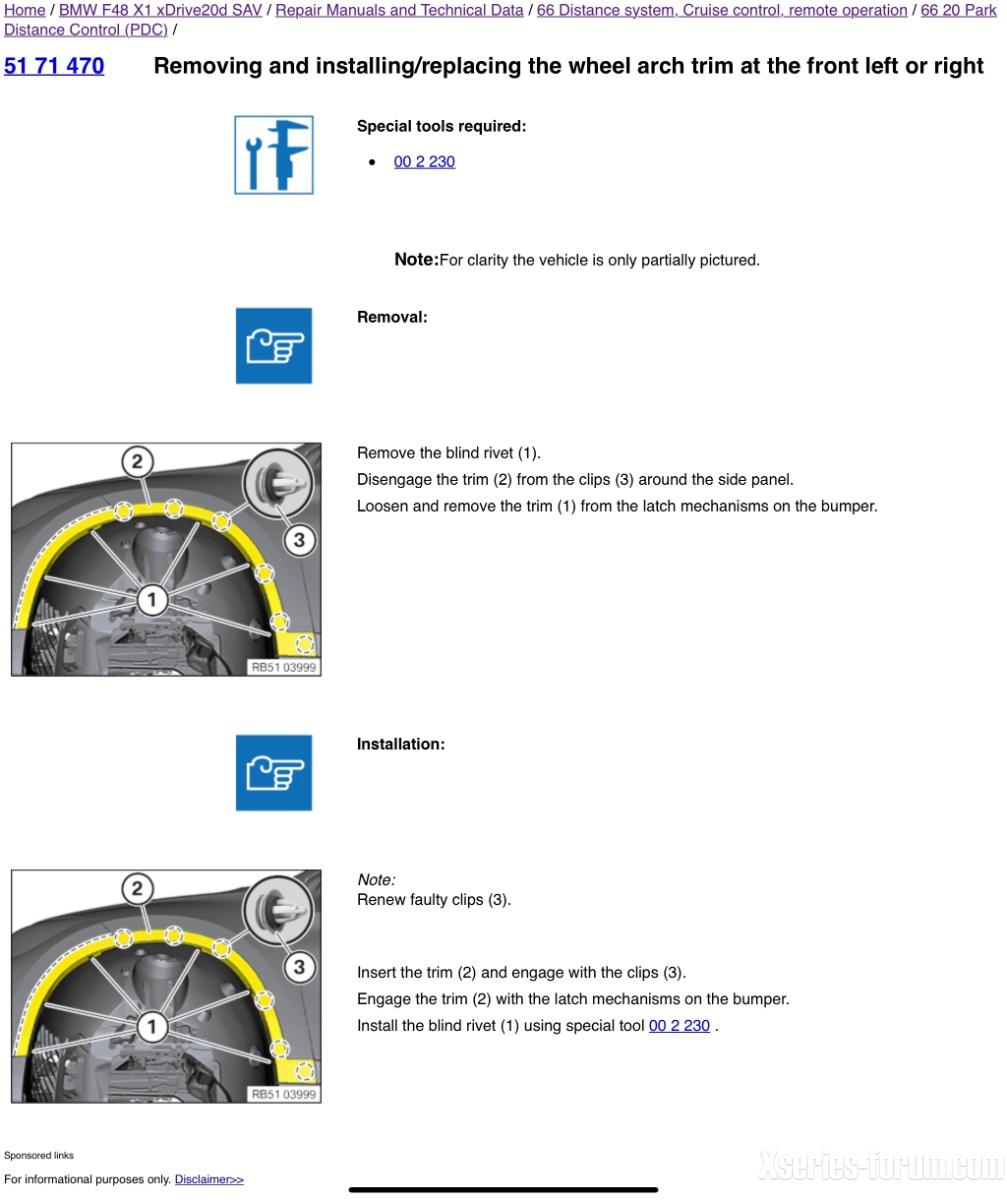

Wheel arch trim removal.
