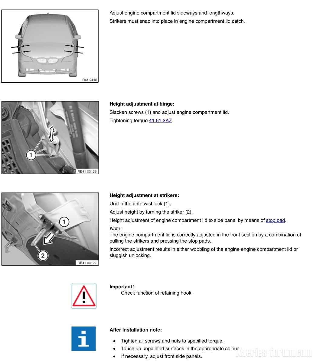

Is there any adjustment possible on the bonnet catches on the F25? To my eye, our bonnet sits fractionally too high (above the grill) and could do with closing just a little bit tighter. Just wondering if there is a way to do that?

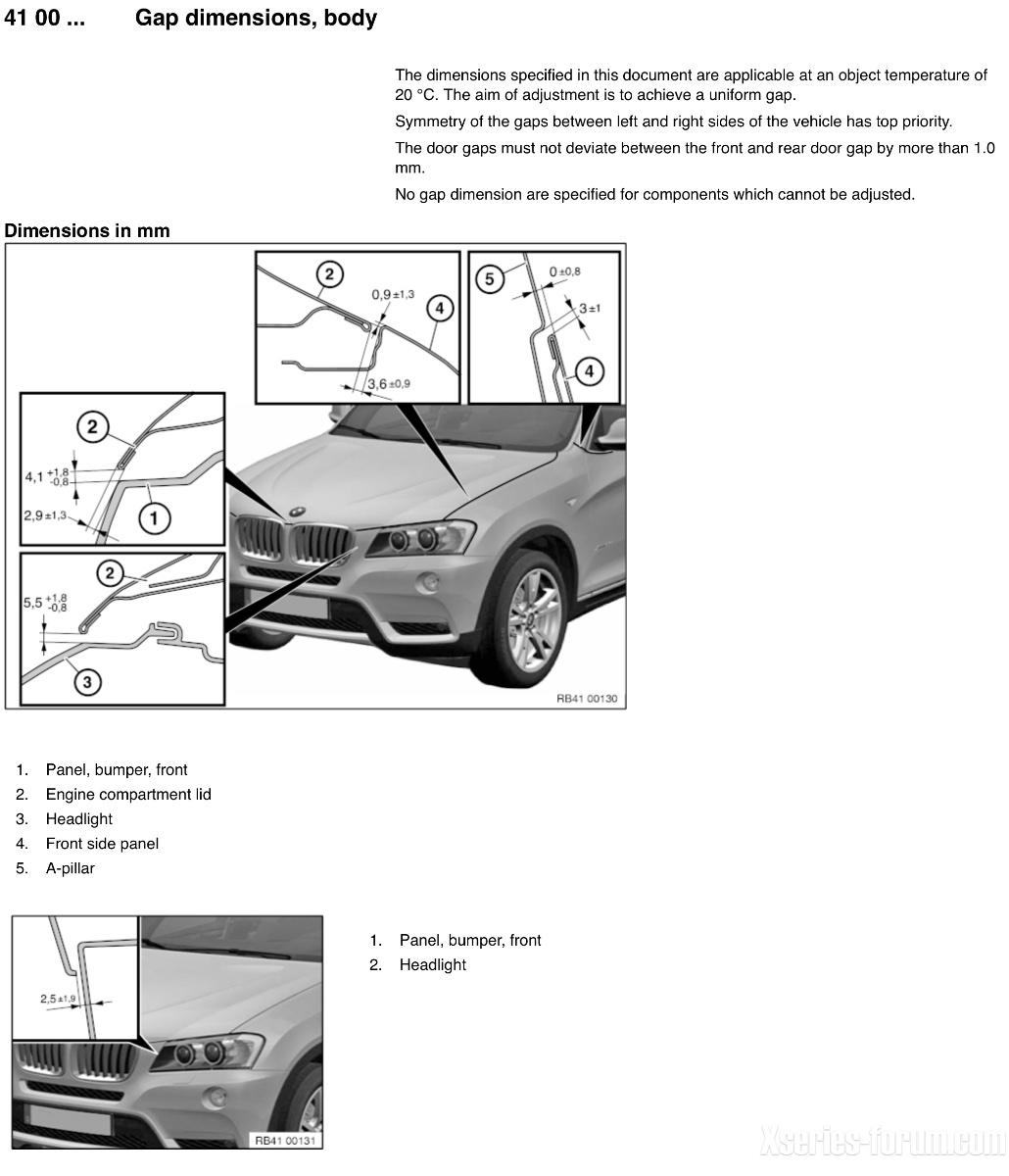

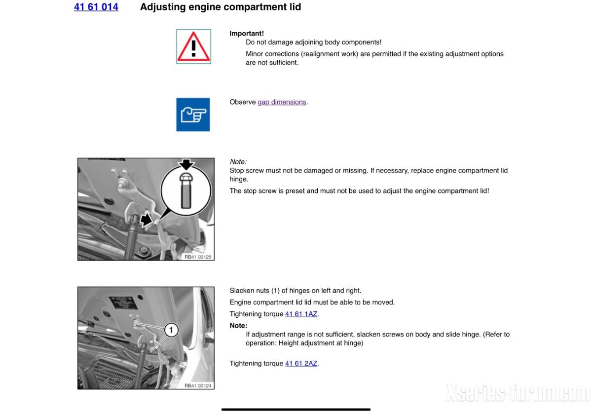

This…dimensions first, then how to adjust.

That’s brilliant, thank you so much, best answer to a query ever !
I will see if I can make some adjustments tomorrow :thumbsup:
