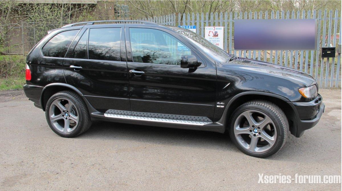

I had the arch trims on my 4.4 with the type 87 wheels. As it was black anyway I never really fussed on the bumpers.

The guy who was once a member here and bought my 4.4, had apparently acquired a 4.6i exhaust but never fitted it before he sold the car on again, i think that was for sale here but a long time ago now
The phat ass look really suited it, i still miss the V8 growl. As quick as my X6 is its not the same noise.

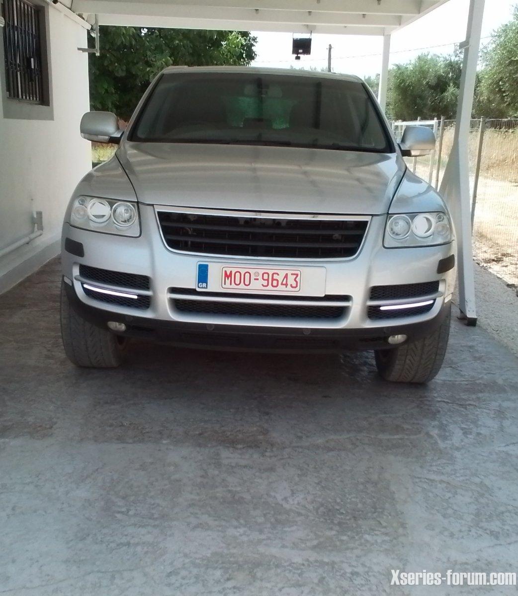

The obvious, though maybe inaccurate conclusion is, you finally bought a 4.6i
But then you've flirted with Cayenne too iirc? I have a Cayenne sibling here in Greece, lowly spec engine which suits my life when here (50kph speed limit) but really high build spec.. Everything is electric, including seat-belt height adjustment, something the X6 doesn't have.
If you reveal a Cayenne, I'd suggest you'll be very happy with it. The Touareg is an accomplished bit of kit despite its age, the Porsche will doubtless be better still.

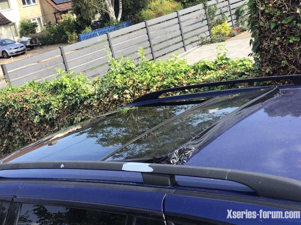

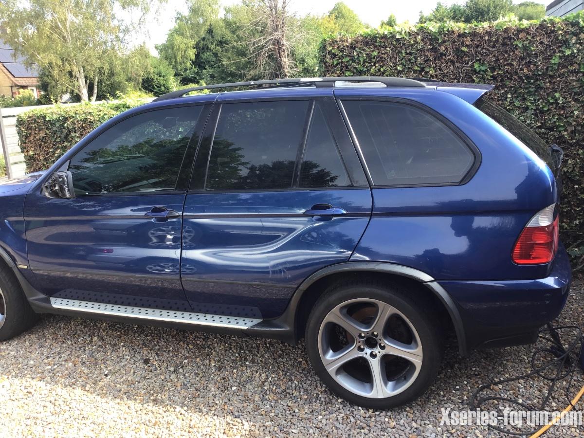

Ok. It’s been a while cause I’ve been away but I have finally got the other X5 on the drive. Bodywork all round is ok apart from the n/s front corner bumper and wing. Fortunately the black wheel arch trim has survived… The 3.0d fires up instantly and idles really smooth - there is 3/4 of a tank of fuel in it too. Bonus. The 20” alloys and tyres are way better than I expected so that’s good.
It has a funny sunroof that I haven’t seen before (unless it’s a pano roof and I’ve never noticed) . The front part of the roof works but the rear bit is stuck in the flip up open position. Both door mirrors are smashed too but that’s about it.
I don’t think the transmission is at fault with it as it makes an awful grinding noise when in drive or reverse but it seems to shift gears ok. My scanner showed two faults- 4F7A EGS: signal from transfer box is faulty and 51AD EGS: no message from dynamic stability control.
The other fault codes were just glow plugs.
If anyone can shed any light on the codes please do so. I’m hoping it’s stripped splines in the front driveshaft as that’s easy to fix.

The first error code comes up exactly as you wrote with no other info. On line search suggests the plastic gear in the transfer case has gone.
The second code reports: 51AD No message, receiver EGS, transmitter DSC. Transmission control
That’s all that shows. On line search suggest that it could either be the scanner can’t talk to the DSC system or a suggestion is there’s an issue with the ABS/DSC control on the ABS module itself. Worth checking the wiring. If that’s intact, you may need to send the ABS module away for repair. In itself the ABS may be fine, just not talking to anything.
Sunroof failures are very common on E53s. A white metal casting shears and it can be fixed so that the rear panel drops but is fixed in place. It’s been on the forum in the past, or possibly have a look on Xoutpost in the US. The proper fix is a new sunroof cassette!

The plan ahead is to swap the wheels, the wheel arch flares, the tinted glass that’s easy to take out and maybe a few other bits from the blue one to mine. Attempt to get the blue one moving then just sell it as it is. I don’t want it on the drive very long. And if I can shut the roof that would be good..
What does the plastic gear in the transfer case do? My 01 doesn’t have that. The noise it makes does not sound like plastic that’s for sure. It grinds in drive or reverse with my foot on the brake. I’m going underneath later to check the front driveshaft.
