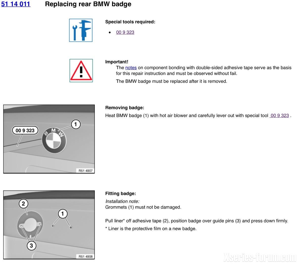

By chance I know this one ….having the same car helps!
The special tool is no more than a thin plastic wedge. You’ll need a hairdryer to warm stuff up….masking tape on the paint around it might help - or make sure it’s clean so no grit scratches etc.

Post by X5Sport » Sun Oct 09, 2022 7:35 pm
Is it still held via being taped on with a double sided adhesive pad though?
I was looking at mine earlier and wondered as mine is on a stand-off chromed widget. Is it just a case of applying gentle heat?

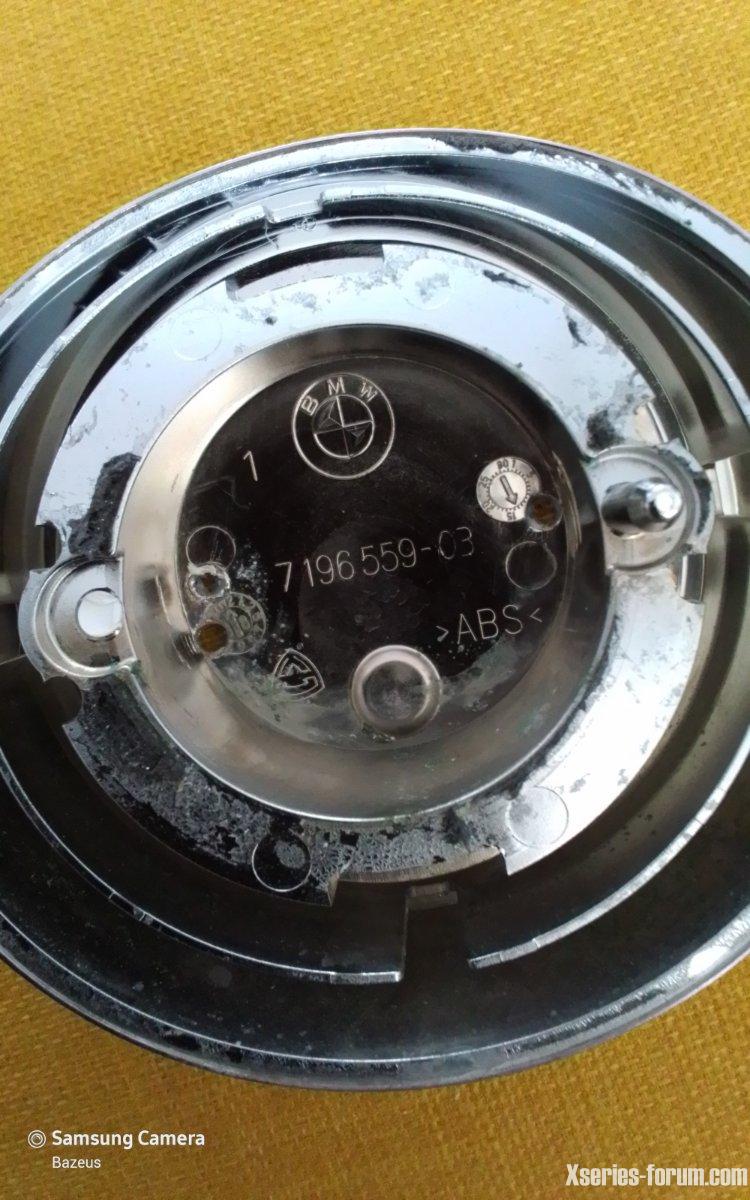

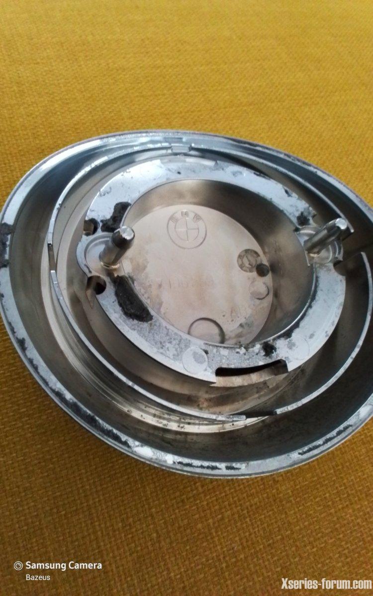

Post by sapphireblack » Mon Oct 10, 2022 3:38 pm
Images for reference. This is definitely a one piece item, I tried pushing on the roundel from the rear/ inside through what look like access holes and that only punctured the roundel. Maybe it starts as two pieces but they are fused together in some way?

Post by sapphireblack » Tue Oct 11, 2022 2:10 pm
New badge arrived via postie today, its on now and has finished the look again. I still have a gloss black covering ring but do I fit it to cover a brand new badge?
I noted the new BMW badge has a drain hole area at the bottom. No nylon locator grommets either. Two locating pins on the moulding and it seems the self adhesive tape is no longer enough for a water exclusion fit ?
