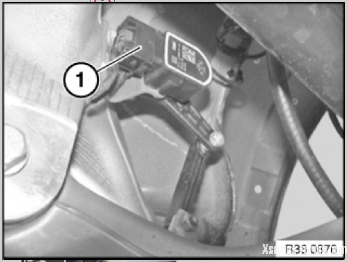

Ride height sensor would be the obvious one to check. There’s two of them on the rear axle - one each side. There are also two on the front axle. If the rear one fails (and they frequently do!) it can cause the car to pump to full height and handle like a monster truck as well! If it needs changing then the system will need to be recalibrated. That needs a dealer visit, or to an Indy with the right software. You’re looking for these……
Either an arm breaks or the sensor goes bad (water ingress is often a cause).

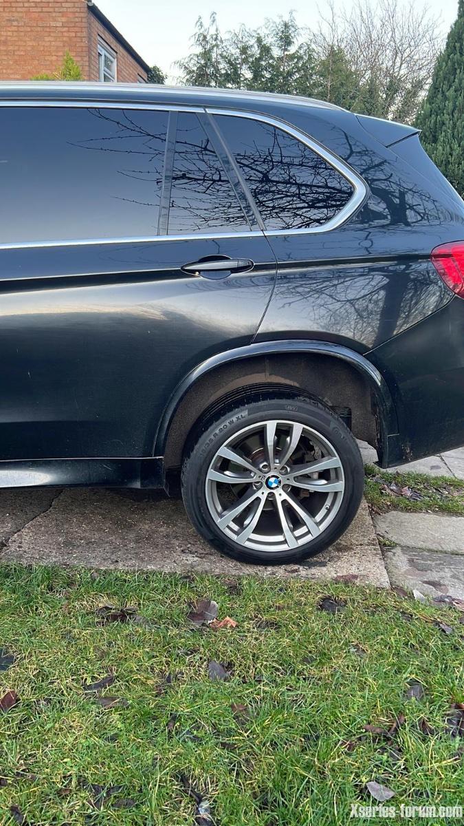

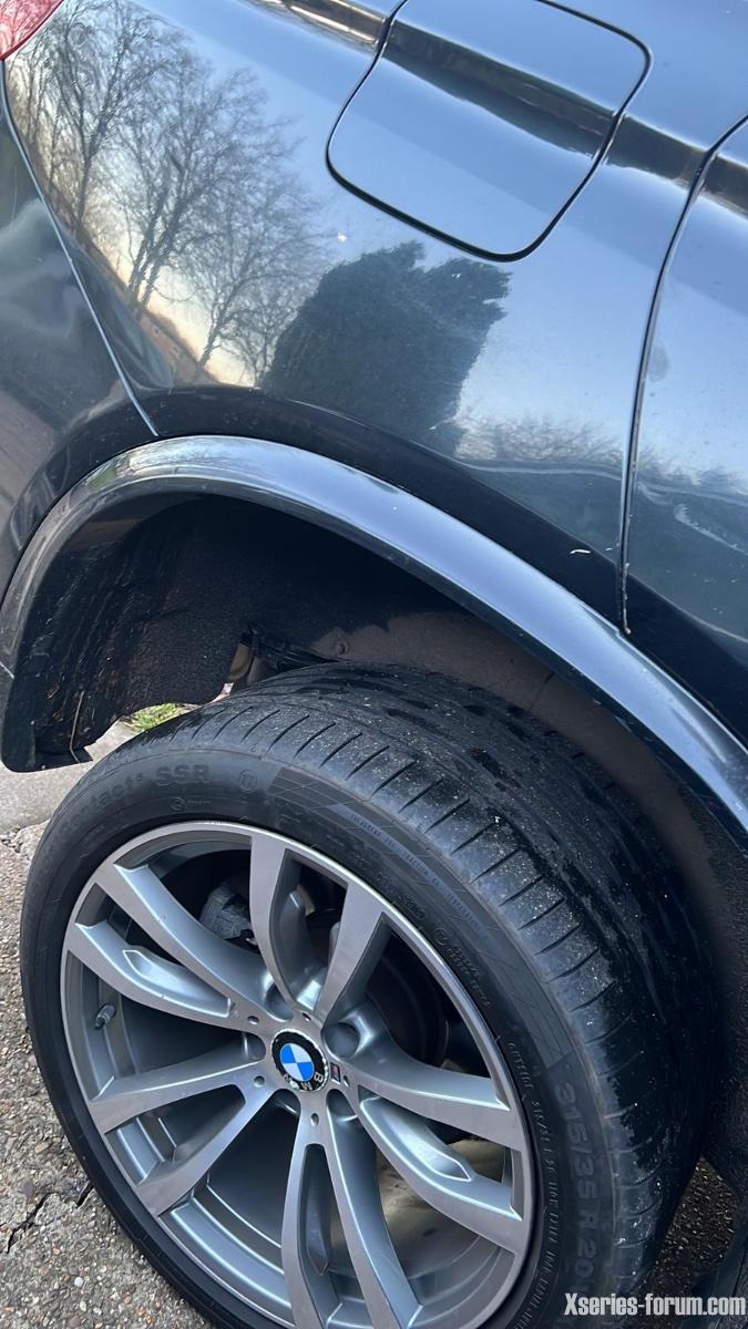

Car was dropped and then we change fuse. Car go high like on picture when We tried to recalibrate this fuse 110 burned out again

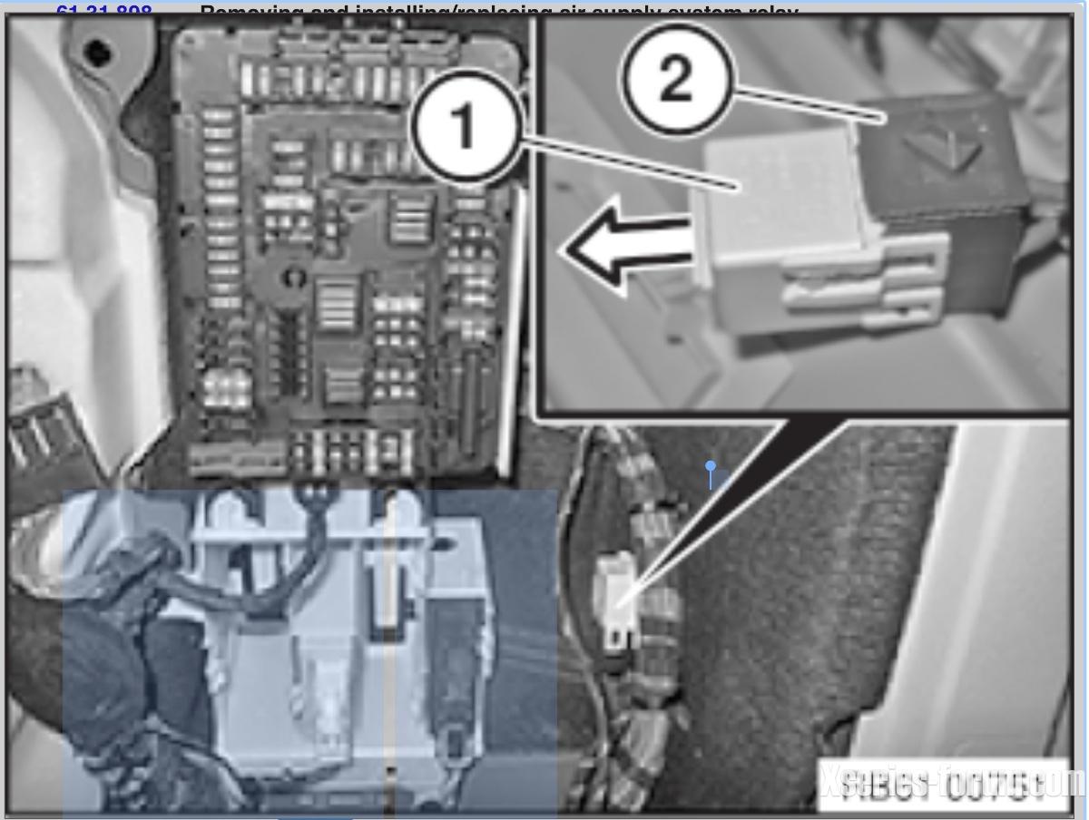

In that case you’re going to need a code read done to find out why. It’s either an overload or a short. Fuse 110 should be a 40A and powers the compressor switching (on/off) relay. If that’s blowing then most likely you have a relay or compressor fault. Given it’s pumping too high, that suggests the pump is running OK but isn’t cutting out which could be a relay issue (not switching the pump off or has a short internally). Blowing a 40A fuse takes some doing and could lead to a fire. The relay is right side boot cubby below and to the right of the fuse box as you look at it and mounted on the rear of the panel….
If it’s getting very hot then beware. You could try unplugging it to see if the car drops. Make sure the ignition is off and the key out!
