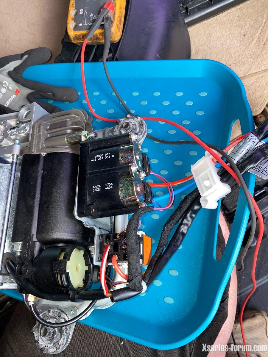

I have seen other posts about this fault, but they don't help with my issue. One day the fault came up, but once you switched off and on it went away, eventually it stayed on, rear suspension did not go down. I googled the fault and there was a lot about the pump piston ring worn, so I removed the pump and wired to switches to turn pump on and operate the solenoids, pump worked suspension went up, after about a month the rear of the car went down and damaged a air bag so I replaced them, I got a copy of inpa and used it to operate the pump and raised to the correct level. Then I read about the module down the side of the battery, checked it out and yeah it was full of water, I bought a used working module and installed, still had the fault, cleared all faults with Inpa but fault still showing on the dash. I then replaced both level sensors on the back suspention, fault still on dashboard, took it to the garage for them to clear faults, they reported there were no faults showing. At the moment every 4 months I have to connect with Inpa and pump the system up.
Can anyone help? This has been driving me mad for over a year

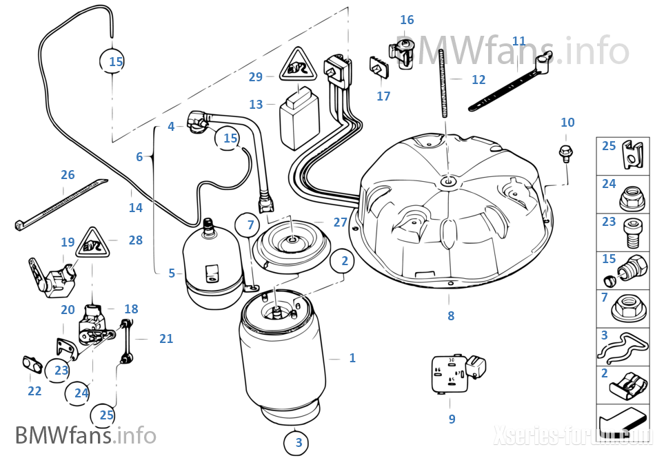

That is a picture of a 2005 3ltr d and item 9 is a relay. So I assume you have one tucked away somewhere

My old E53 V8 had what I always believed was referred to as the "german helmet" item 8, in the lower boot area. I didn't recall that the car had air suspension as i never had any issue with it in ten years of ownership. Was I lucky (though had plenty of other unrelated issues) or is my memory failing me and the car didn't have rear air suspension?

If it had the helmet it may have had just rear self levelling air susp. The full fat version had a ride-height adjuster (thumbwheel) on the lower dash.
