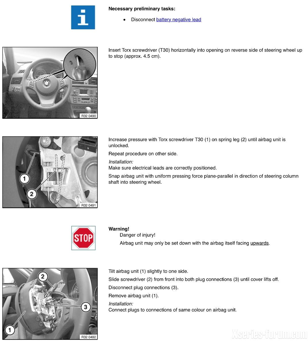

Post by X5Sport » Sun Jan 08, 2023 3:07 pm
Sounds like an electrical fault in the wheel itself.
Probably worth removing the air bag module to look within the wheel switchgear housing (from memory I think it’s done by putting a long posidrive or similar screwdriver through a hole on the stem behind the wheel at about 10:00 and 2:00 and pushing to release the spring catches that hold the airbag on). Disconnect the vehicle battery first!
I had an issue in the E46 caused by a loose screw shorting things out….including the horn switch (which got a bit embarrassing until I could get home and dis the battery!).
With so many things all happening together my mind is going to the wheel first.

Post by henrym3 » Sun Jan 08, 2023 7:26 pm
Going to take the airbag of tomorrow and have a look. Does seem electrical as the buttons operate different modules so they haven’t all gone pop.

Post by X5Sport » Sun Jan 08, 2023 9:28 pm
This might help……
