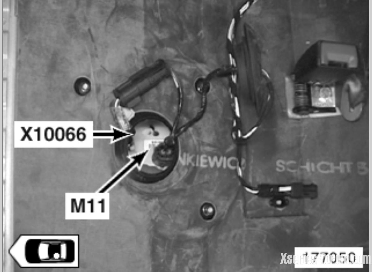

There are two fuel pumps, one in the tank and one under the floor (an inline pump in the fuel feed) - are they both running? The car should start if the tank pump fails, but not if the inline one goes down. Unit M11 here (under bench seat, left side)…

The fuel pump under the rear seat does hum a fair bit with car in on position before cranking.
Whats the next step of finding the root cause? Would the culprit still be be fuel pump or fuel pressure?
